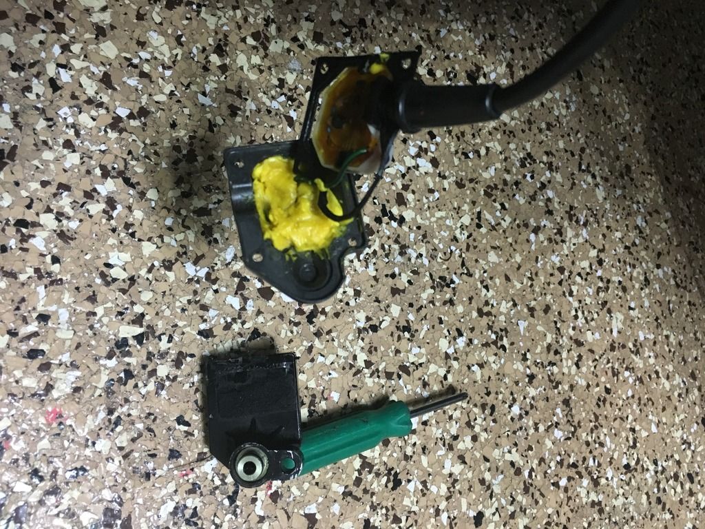

For those of you that had cleaned the speedo box of an interstate, is it supposed to have this big yellow paste acting like s cushion or this is not supposed to look like this. Thanks to all

« Reply #20 on: October 04, 2016, 07:53:30 AM »
That, does not look OEM to me!
2000_Valkyrie_Interstate
larue
Posts: 1660
Clermont,FL
« Reply #21 on: October 04, 2016, 08:05:21 AM »
Have you opened one before and does it look like this or not
Posts: 15372
« Reply #22 on: October 04, 2016, 08:20:12 AM »
Doesn't look OEM to me either. Sumting Wong!   Wink
larue
Posts: 1660
Clermont,FL
« Reply #23 on: October 04, 2016, 08:42:54 AM »
The one in the mail looks just like it from the outside. Still waiting for Mike in AR or someone who had just opened one  or can post a pic of what an inside oem one look like

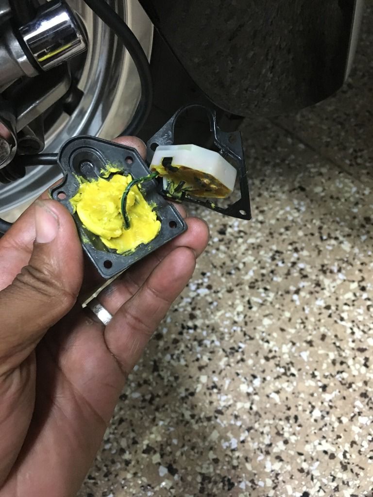

« Reply #24 on: October 04, 2016, 09:30:28 AM »
  Your's look's normal . Mine had a potting compound in it I seem to remember it was clear . It was over ten years ago   ???   Here is a fuzzy picture of it cleaned out.  I cleaned it out so I could repair it but was non repairable.

« Reply #25 on: October 04, 2016, 04:08:01 PM »
larue, i apologize, I meant to get back here to tell you that yours looks just like mine, but got sidetracked. Family has a way of doing that to a fella. lol Anyway, as I said, your sensor looks no different than mine, so you are good to go.
