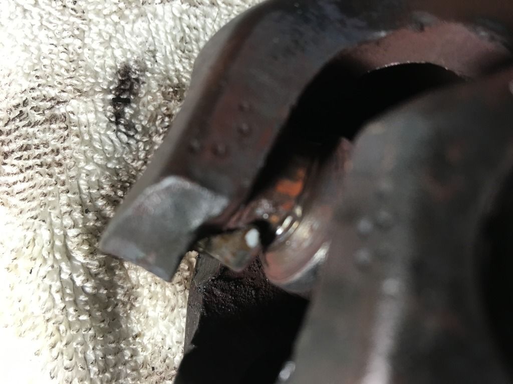

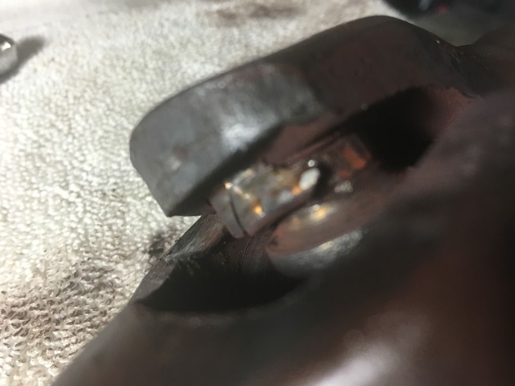

When was the last time you checked your U-joint? This is what I found when I experienced vibration on my footpegs.

WOW! Shocked   I sure hope not! She just turned 30k and never been checked since I owned it
