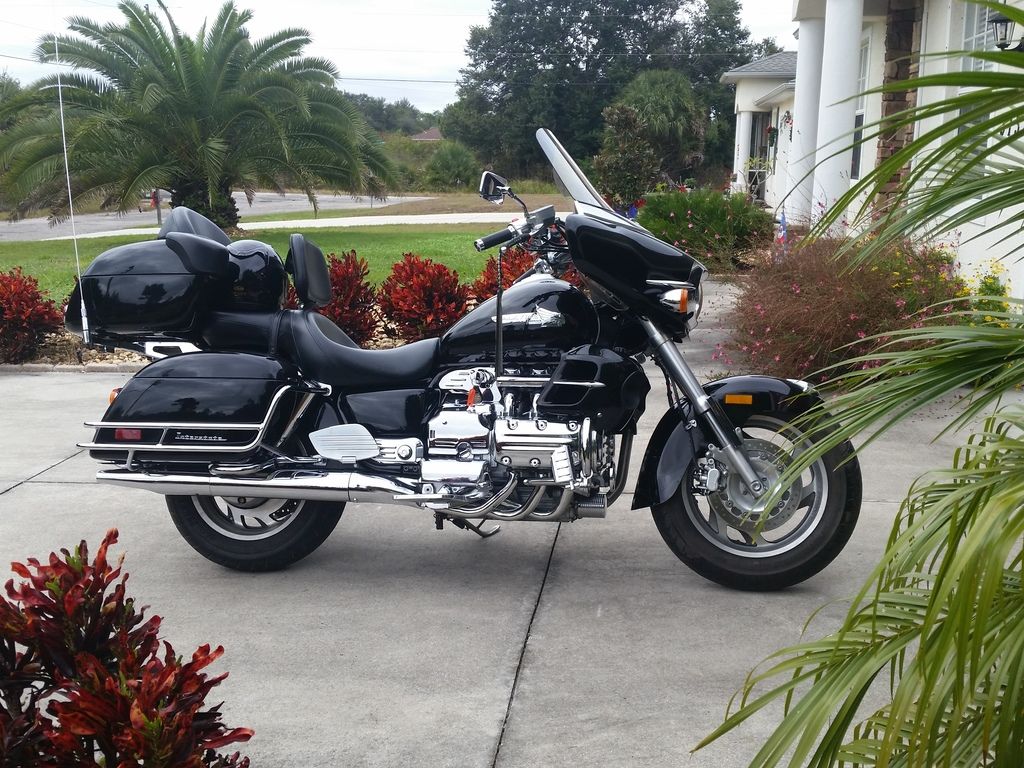

It's such a freaking game, some have gone forever without a hydrolock, others have seen & felt the damage. Those that have gone forever are lucky dogs.. Some time bk i had one of my Valks lock up. I used the bike all the time, ran absolutely great, no signs of any problems. One day after riding I let it sit for an hour or so, gave it a washing, went to start it & that was it.. After pulling the engine & replacing the starter gear, which I still have the sheared off gear hanging in my shop to remind me, I always shut off the fuel supply.  Replacing the OEM parts valve with a Pingel is a little cheap Insurance for me with a mechanical valve. Just to much dirt/sediment can screw up the original valve in my opinion. I've been on a goldwing for a bunch of years & still enjoy it. I picked up a Really nice & clean 01 interstate with 22k on it. Will end up super valking soon. Feels real good to be back on the Phat lady again!!
The black one in pic was the one I had problem with..
[/URL
Pic of my new ride..
[URL=http://s1158.photobucket.com/user/goldwing2008/media/20161221_141546.jpg.html]
