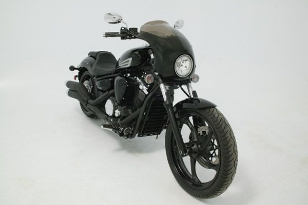

THIS is a Bullet Fairing by Memphis Shades, I think on a lowered, boobed Valk, it would be great! They just dont make one for Valk so I wonder IF anyone has modified one to fit..

Two issues.
First, the mount to frame/forks and/or handlebars would be fairly easy to adapt from existing Memphis aluminum mount hardware (spacers if necessary are easy to fab from aluminum flatstock). Note the valk's forks are big and fat.
Second, the std/tourer valk headlight is large (aftermarket windshield mfgrs do either a 7 or 9" headlight cutout for valks.... I have interstates, so not sure).  But if the headlight cutout is too small, I think you are out of luck.  Doing a perfectly round and seamless cut to enlarge that cutout is not in MY wheelhouse anyway.  Although a ragged edge could be dressed up with auto parts vinyl edge trim. And some auto glass replacement outfits can do some pretty nice side work for you.
Memphis makes a whole series of smaller Sport Shields to fit metric cruisers that would bolt right up (admittedly not exactly the same look).

Anyone using a memphis shades "Bullet Fairing" on their Valkyrie? They don't make one specifically for Valkyrie. I'm raking mine 6 degrees and think having one wold be a great idea. Maybe a HD road king bullet fairing could work? Any ideas??
Never seen one of these on a road king, check out bigpappapump he had somewhat similar one on his standard

Yes....with some big p-clamps and Memphis shade bracketry, the bullet fairing will fit. I got one that was made for a vrod originally in flat black and I gotta say, on the Valkyrie, it looks bitchin  Smiley Smiley
