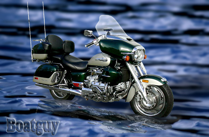

One of mine came with them, the other didn't.
I have no schematic.
But, they sort of wrap around the outside edge just a little bit (so I think there may be a bit of curve in one edge.
So first I'd put them up on the bags with the adhesive cover still on and fiddle around for best fit and look, measure up from bottom and/or down from top, stick a little painters or masking tape at the mount points.  Then just do your best to get the other side in the same position.
If one side is a bit higher than the other, you'll probably be the only one who ever knows.
It's hard to find good pics of them (see how they wrap a bit around the outside edge?).
Clearly, the red bike has them lower than the green bike.  And I would err in taller rather than lower.  BTW, the red bike bag guards are NOT OEs (or OE copies).
If you ask, I will go out tomorrow and measure how far down from the lower saddlebag top edge they are on my bike (not counting the lids).  I know that most of the Honda extras that came on my interstate were installed by a dealer (way back when they knew what a 1500 Valk was).
