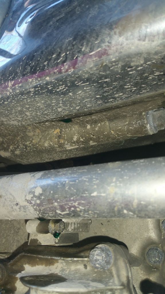

« Reply #3 on: February 05, 2017, 11:40:59 AM »
Yes I know its filthy. It's my daily driver.  This is from the front clutch side. yes I see its wet at the upper hose on the housing. If you look above it there is coolant above dripping on it from timing cover.
this view is from just in front of the shifter looking forward.  you can see it dripping from timimg cover onto crash guard
from what I can see the radiator and top of timing cover is dry.  coolant was flushed 5 months and 8k miles ago.

« Reply #4 on: February 05, 2017, 12:00:13 PM »
Still seems likely to be the top hose clamp, with green stuff flowing down over stuff.
Real common occurrence in cold weather.  Even without tightening, most leaks stop after running hot for awhile.
I am just guessing.

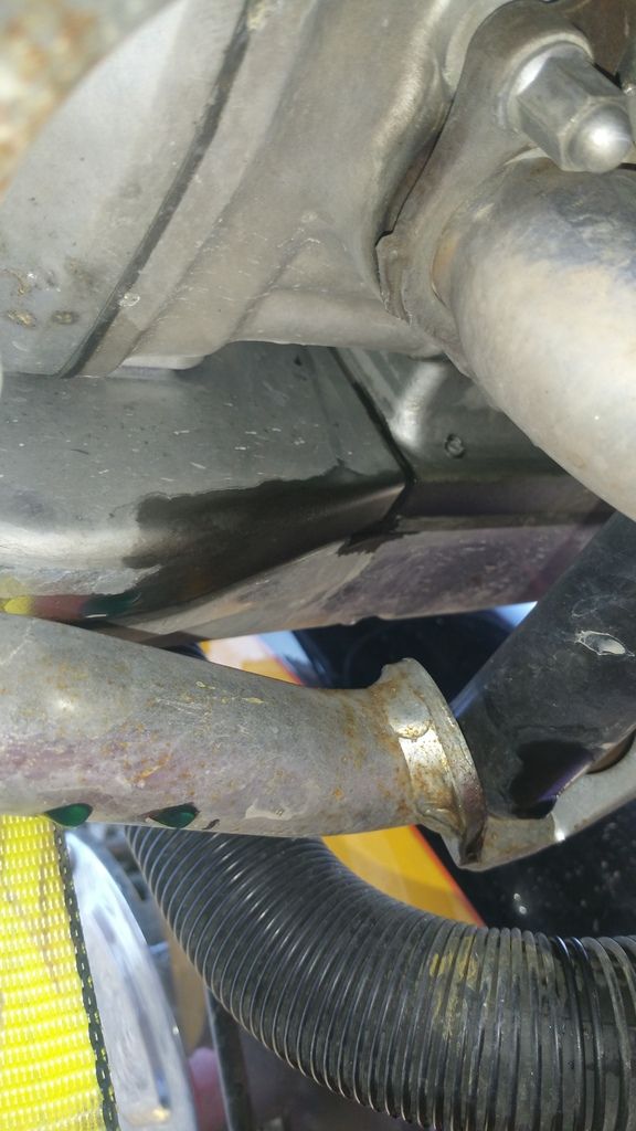

« Reply #14 on: February 06, 2017, 02:12:04 PM »
Mine was leaking from the lower rad hose, on top of the engine. An extremely shaky and blurry video of it:
https://goo.gl/photos/zuLXBQwPAsupPgVu7
Photos when I fixed:
https://goo.gl/photos/QNU3yeGozRgcwRqLA

« Reply #15 on: February 06, 2017, 02:34:23 PM »
Saw that leak too on mine when I did a desmog and carb rebuild. I tightened the clamp and it seemed to stop. If you pull the airbox and pull out or bend down the plastic radiator shield you can also get at that pipe. Might be easier for some.....I'd do it that way vs. moving the radiator out of the way, but that's me. You might be able to sneak a thin ratchet extension in there without doing either if you just want to tighten the clamp.

« Reply #17 on: February 06, 2017, 03:42:58 PM »
The 'correct' way of having access to that hose would require to remove the gas tank and those panels at the neck (between the frame and the tank), followed next by unplugging the radiator fan wire and next you could get the upper hose free and get at the radiator.
What I did when I installed a water temperature gauge was installing 2 brackets in that hose. Full thread:
