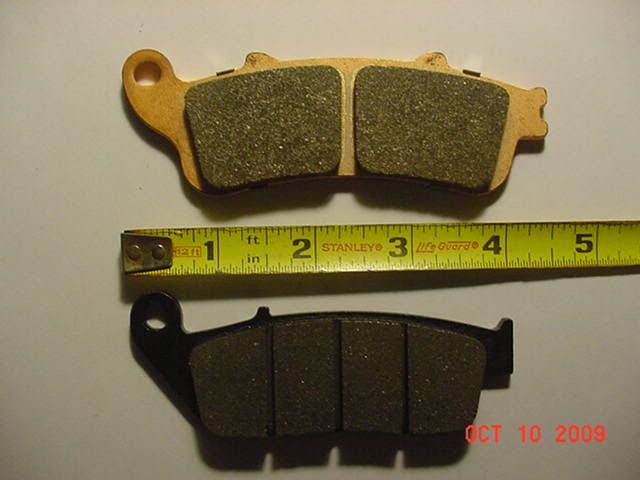

« Reply #4 on: October 10, 2009, 05:17:09 PM »
2000 Valkyrie Interstate
A picture is worth a thousand words.
Rear pads are at the top, front pads at the bottom.
2000_Valkyrie_Interstate

« Reply #5 on: October 10, 2009, 05:43:24 PM »
Those pads do indeed measure differently. You need to check the numbers. One of them isn't correct.
HDL specifies 06455-MV4-405 for the front brakes of  Valk Standards, Tourers and I/S.
I have two sets in unopened blister packs. They measure 4" overall.
HDL specifies 06435-MBY-671 for the rear brakes of the I/S. I have two sets them in
unopened blister packs. They also measure 4" overall.
If my daughter hadn't screwed up my digital camera I would post pics.
Maybe someone else can verify the measurements.

Posts: 14779
« Reply #8 on: October 11, 2009, 12:40:12 PM »
I feel confident that pad on top in the picture is not the correct one for a Valkyrie
Posts: 17016
« Reply #9 on: October 11, 2009, 04:31:41 PM »
Rear thicker than the front that's the only difference.I think you may be right Chris Valks have only one nub on the top the top pad has 2.

Ok now I'm starting to wonder what I've got. I started this as I had a pad on the front get down to metal. I had saved a few old pads from earlier changes and did not know which were front or rear. the Only difference I could see in these pads was a notch in the front of some pads and no notch in others.I front pads I removed didn't have a notch but the pad I replaced it with had the notch but fit perfectly. I just ordered a complete set from HDL so I'll be able to eyeball to pads soon and I check out the wills and won'ts of this question. :-\TIA
