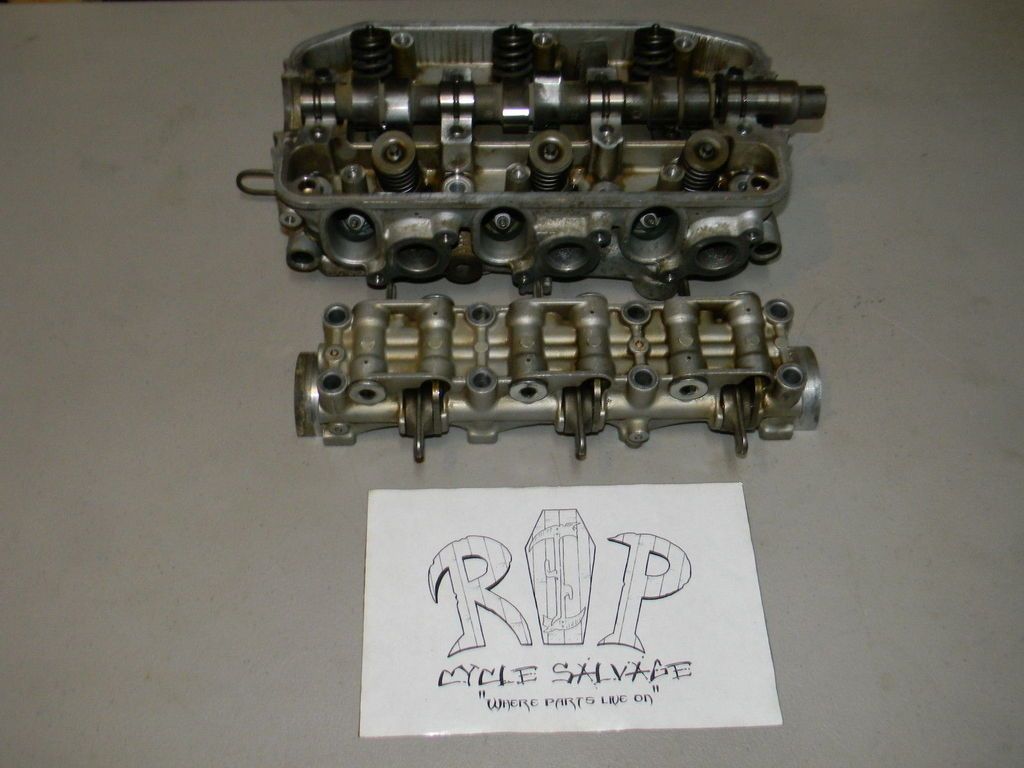

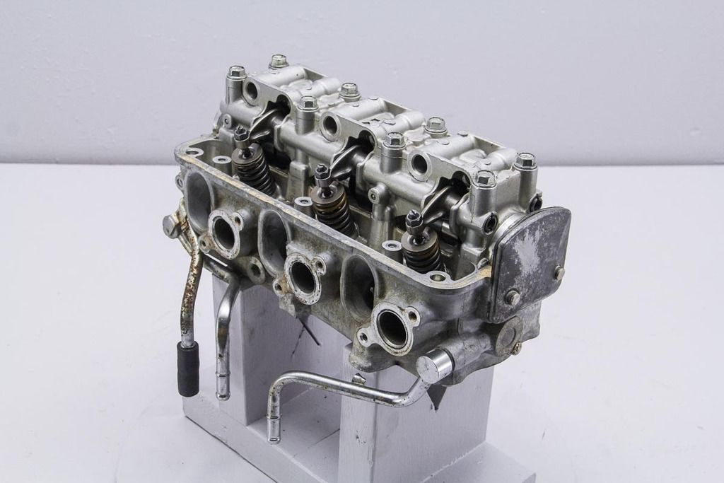

Actually, I just was helping a friend clear up some confusion about his '97 having solid lifters and catalytic converters. That led to GW1500's having hydraulic lifters and I got curious (I know it killed the cat), looks like the gl1500 was hydraulic until '98 and it got the valk style valve train. But I am still curious as to the lash adjustment in the hydraulic style heads.......I can't find no stinking lifter.
Well I will be cursed!!!!!!!!! I just looked again at ebay heads and finally see how they did it......there are 6 bores on top of the the cam retainer plate. The gl1500 rocker arm has a protrusion that extends up to the end of that bore and the hydraulics are in there. They just blocked off the bores, removed the protrusion on the rocker arm, added the screw/nut adjustments in a new arm for the valk heads (and later gl1500 heads)......
Rio Wil
Posts: 1370
Re: Someone "Splain it to Me"
February 13, 2017, 04:41:20 PM »
In these two photos, you can see thew protrusion on the gl1500 rocker arm that extends up into the end of the bore on the cam housing.....on the later head, the bores are simply not used , no protrusion on the rocker arm......Honda just used the same cam cover and didn't machine the bores out for the hydraulics.............Oh
well....

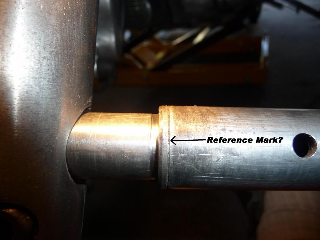

Another thing along the development line and apparently undocumented anywhere is the front axle alignment mark that makes short work of knowing for sure you have the front axle inserted the proper distance......would be no more questions about 'hey, I removed my front wheel and now the rotors grind'....its a dead sure alignment method.
Anyway....its kinda fun to discover stuff like this.....what the heck....
