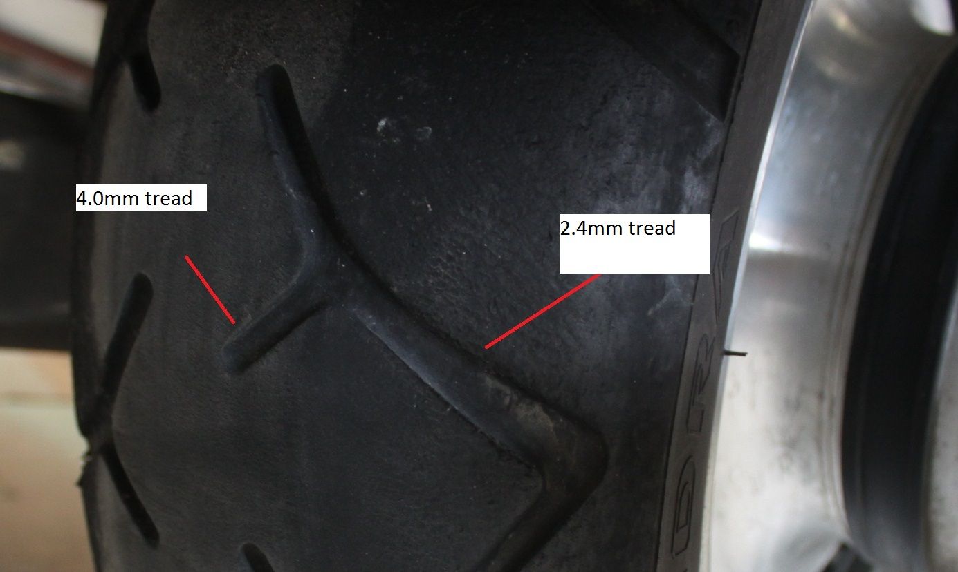

I haven't had the bike long and am only just starting to clock up longer rides now, The front was worn to an ...well octagon type shape, with that cornering seamed a little unpredictable... with the bike having a dropping feeling in stages... I started looking at front tires last week, then over the weekend I traveled some nice back roads and now the rear is like it too, I took it quite easy compared to what I would have on my older Shadow...... but it has torn up the sides on the tires a bit.
I have Bridgestone  701/702 tires, Were like new with the bike but 6 years old....so I thought they might be hard... but seamed OK as 150 odd miles was in Rain yesterday and it gripped OK
Is that normal? are other tires better??
CT is not an option here as it has to be a bike tire to get a warrant of fitness
Edited to save confusion
Updated pics to show the center is normal, sides are the flat areas Smiley
The common thought is more pressure as the tire heating could be the cause from not enough pressure (was tested today and it had 36, front 38 still so the rear has dropped 4psi)

« Reply #2 on: February 20, 2017, 04:21:11 AM »
It is weird how the left side is more squared off. I haven't seen that on any of the different tires I've used. I wonder if it has anything to do with riding on the left side of the road ? Over here our front tires wear the the left side more than the right. Does your right front wear faster ?

Hey Leathel. What tire pressure are you running? Squared off tread pattern is normal depending on how and where you ride. The important thing is handling, tire pressure, and paying attention to the wear bars. I run Cobras, and that seems to be the recommended regular MC tire for Valks. I like them. I keep them at 42psi front and 44psi rear...and I check that pressure every ride. I only have 6k on a new set so far, but there are so many twisties and curves in this area that I get few opportunities to ride in a straight line, and so far no center tread strip is evident.
I cleaned the dust of one side and not the other... They don't look as uneven in person (my red lines are not accurate either)
Front looks almost even but both sides are flatish like the rear
Running 38/40 PSI and they were checked a week ago, will check when I get access to the bike (workshop is packed ATM)
I priced some Cobra's up last week and they gave me sharp price.....but nil stock of the front tire and not expected for 6 weeks :/
The center of these are pretty good still, more wear on the sides, I will bump the pressure up and see how that goes  (I was riding 2 up, but my son is pretty light weight)....I want them to last a bit longer than these are, at this rate the sides will be toast in 3000 miles  Cry
Front look almost even but both sides flatish like the rear
In that case, I'd say you have normal wear. A little more air pressure might help a little.

Higher pressure would help. But once a tire is cupped, higher pressure won't fix it.
Run them harder in the future.  Up to but no higher than the max psi printed on the sidewalls.

That looks just like the Avon Cobra I removed last season adn is considered normal wear.  It also indicates that you do not spend enough time in the twisties (me neither).
Generally speaking a commuter will wear flat in the centre like yours.  Because of the tread design of many tires you will get the rough on the outsides.  Every tire on every bike I have owned has worn like this and it is apparently normal.

Its the twisty roads that are wearing this tire, the middle of the sides have less tread than the top, but its hard to show in the pic's.
I think it must be the lower pressure (although still above OEM spec) and the tire getting hotter on the corners and most used area wearing (but normally its not worn flat like that for me) I have had a tire flatten on the sides in the past on the 1100 but I was really pushing that and it got cooked, Hot day and pushing it on a softer tire (Pirelli night dragon) and that tire got glossy black and started to de-laminate with spots the tread lifted....but it was near worn out when it did it.
The middle is not as flat as the red line shows, Usually on my 1100 Shadow my tires when worn have a round profile with even wear for all but right over to near the chicken strips as I don't travel strait roads much.... the center has no issue
 this is my normal wear on the 1100
But that is a Bias tire and these are the first Radials I have had on a bike

I use similar Bridgestones and mine are wearing very similarly to yours.  With about 10K on them, I'm definitely getting the flat center.  Most of the miles are on the slabs (it's the commuter vehicle) so I guess thats to be expected.  I run 42R and 40F, typically.  I think you're experiencing normal wear.
