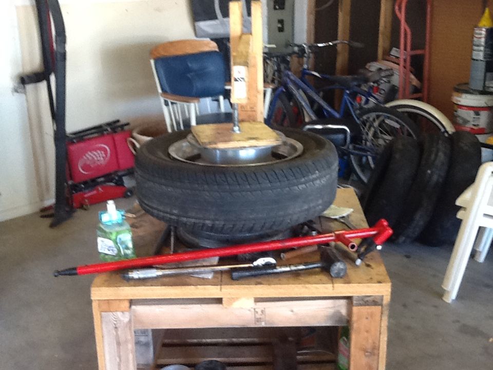

If you don't have a way to securely hold the tire and break the bead, it's going to be almost impossible without damaging something or yourself. I made this out of scraps and an old tire rim. Even with it held down secure its not easy.
  Wow Shocked  I'm impressed, that's a lot of scraps you put together.  Not bad, for a Meat Cutter cooldude
I'm just a cheap bastard is all. My first tire change the dealer gouged me for $200 in labor. My bad for not getting a quote beforehand . But I told myself I wasn't paying that again.
