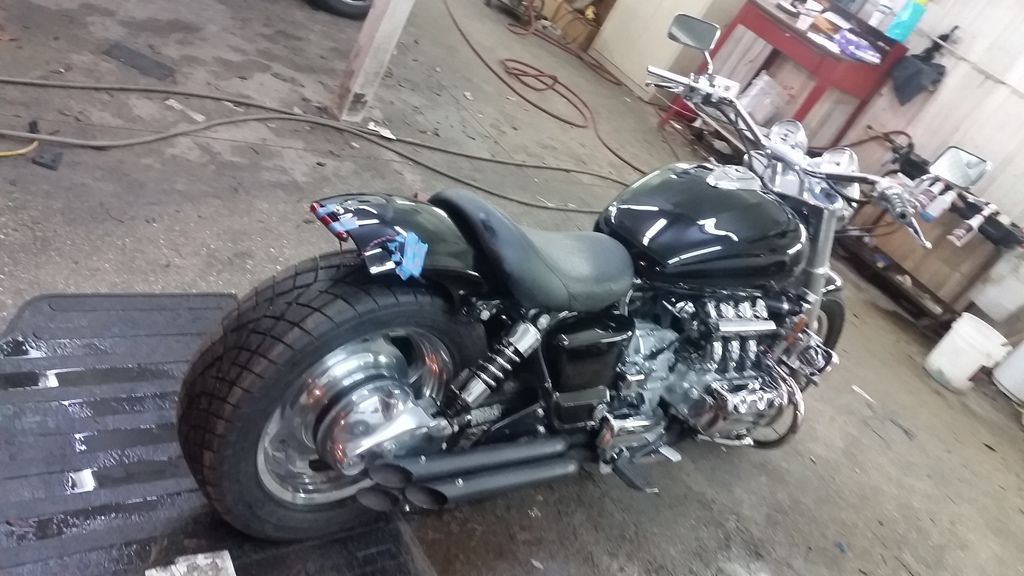

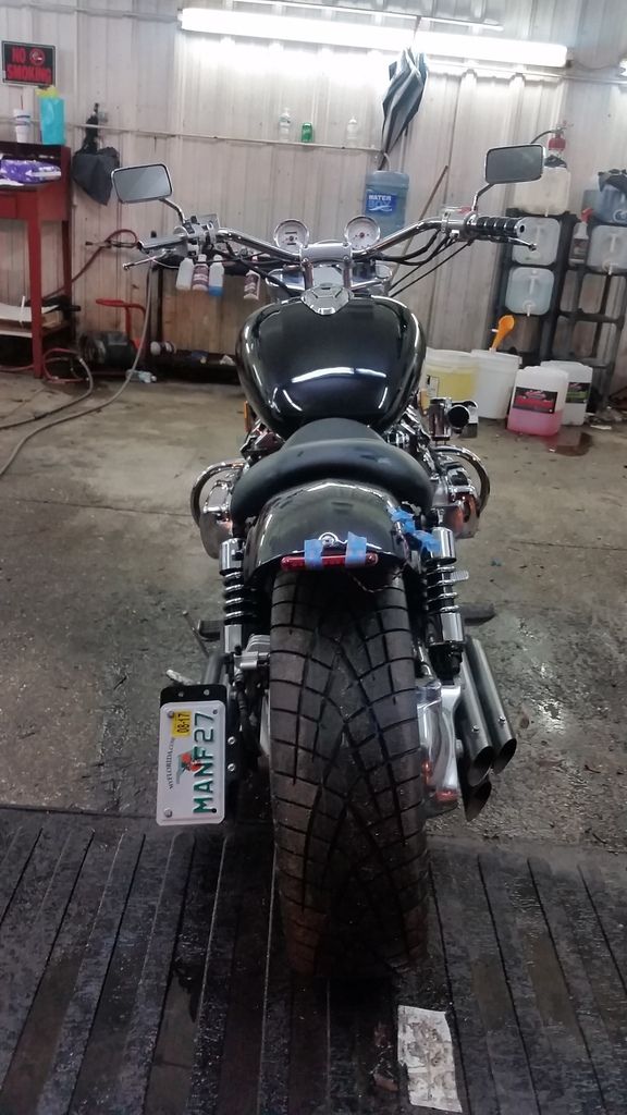

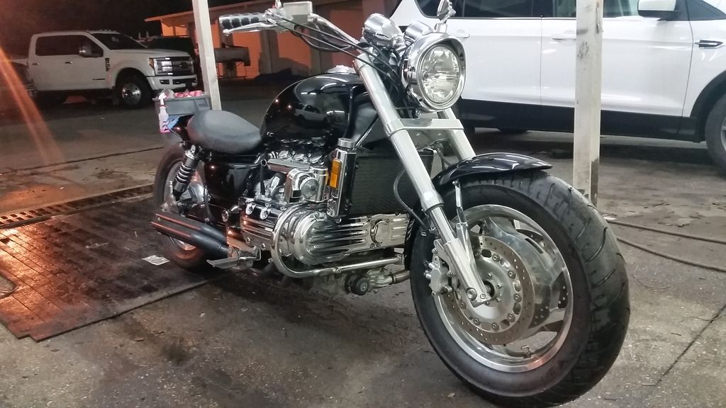

It took me about 2 months to get this far as I could not do it at home so I did it at work during breaks, lunch, and coming in early, staying late.
I ordered handle bar risers after my 1st test ride in the parking lot. My arms are way too short!
The seat is all me, 100% original concept and design. Its so freakin' cool! I can share the info if you want.
I bought a used set of cut down cobra pipes that were ceramic coated, WAY TOO LOUD!  Crazy loud.. I made a set of baffles, wrapped them in glass packing, drilled holes in the rear of each pipe to secure them. It is 100% puuurrrrfect. Very quiet at idle and easy riding but when you crack the throttle, its awesome!
I raked it 6 degrees, cut my own fender, used a VTX up front..
I just have to finish my LED turn signals and such.. What do you think?

 To give it a 6 degree rake did you buy an aftermarket triple tree or modify a stock one or cut and re-weld the frame ? I have heard of changing the rake on a trike but never asked how they did it.  Thanks for any info.

Aftermarket kit that cost 650 it's kind of a pain in the butt to do it by yourself just have a buddy help you out

I would like to know about that VTX fender, is it a direct bolt on?
If not what did you have to do to make it work/
Nice looking!
[ I had to buy VTX fender brakets, line them up, and drill 1 extra hole for the fender to work, easy...]
