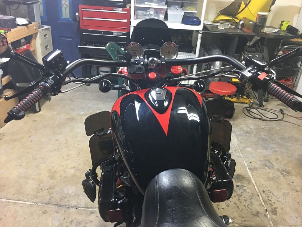

Here's a shot of my nostalgia bars.  Spread your wings and FLY bars!
https://docs.google.com/file/d/0B0TuB7W83hDCTHdvS1QzMGJlaU0/edit
Sorry about the Google Drive link, was before my Photobucket days.  Double click to zooms in.
