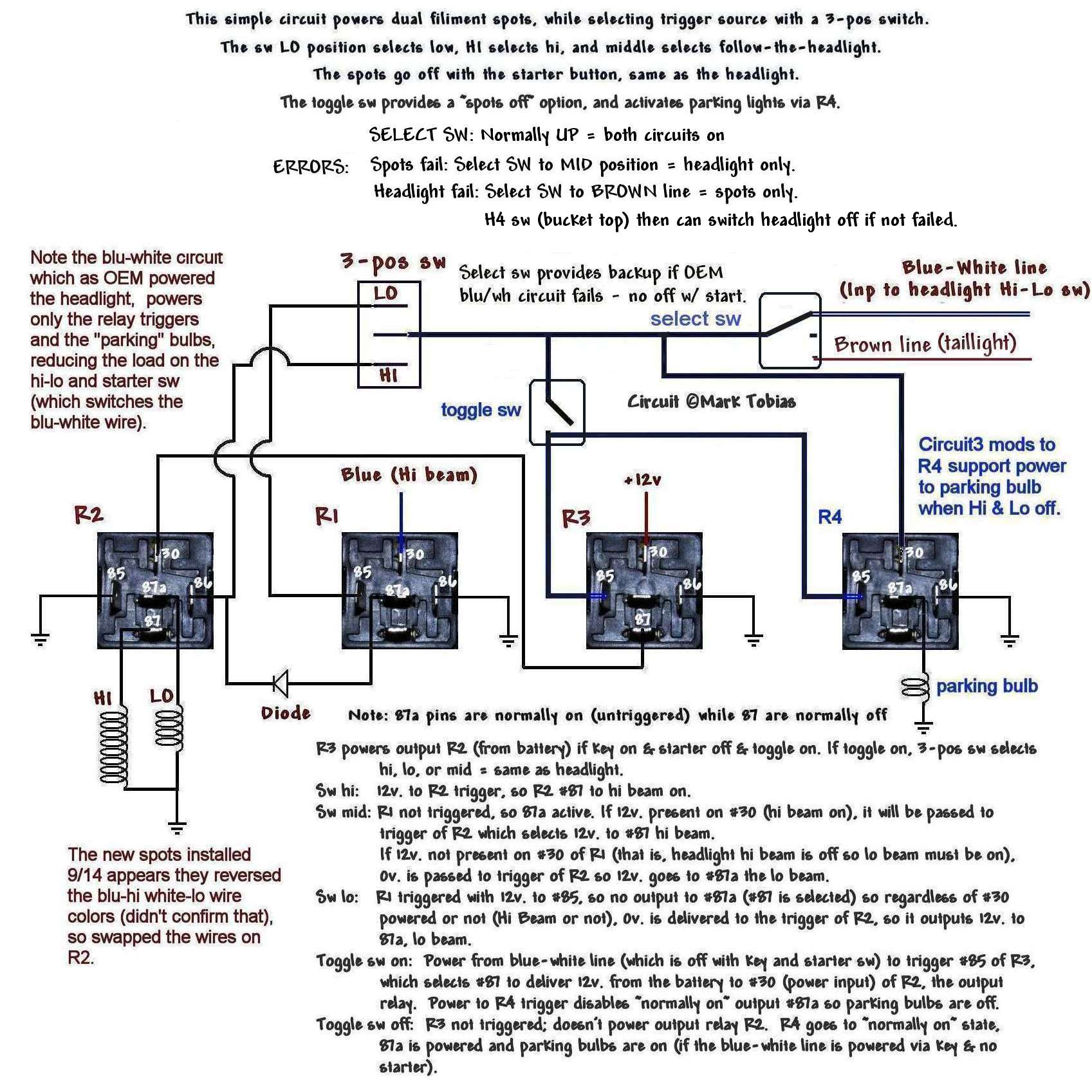

There is absolutely now comparison with incandescent. I have my riding buddies to back me up. They want me to lead at night so they can see in the distance.
Don't want to dis your point, NG - I'm sure your designed-for LED light fixtures are quite bright.  BUT.  (There it is...)  Yours is not the only soln for a well - lit road.  I too am asked to lead on night rides - been that way since 2000.  I think you might be surprised on the light presented by a well-focused 130w high beam and two aircraft landing lights on Deerslayer. (Or the 130/90 main plus a pair of 60/55w H4 headlights on hi beam, on Jade)  Not to mention the other two small 50w halogens on the crashbars - just there for MY visibility / safety at all times. (Don't run the A/C lights all the time.)  Yep these proven - tech (read "old school") lights use much more power but the bike has proven it can handle that even with my stereos running and heated gear - I don't compare as you say, watt for watt.  But this soln was available decades ago before your higher tech LED's were - when I installed them. And setting them up costs less and is easy.  Basically, my Hi-power mod (linked above)  with a $2 fuse holder, 2 $6 relays, a ceramic H4 plug $5, 5 ft of wire & soldering stuff $2, a 130/90 bulb $15,  and an afternoon.  Or buy BonS's Smart Sw - more cost but less time. Not including the spots on the cost figure here - the 130/90 bulb is much more than adequate.  I tend to overkill sometimes but I like to run the spots in the daytime for visibility, having been hit by a left-turner "He came outta nowhere" back in 1970.
George doesn't have a good lighting soln.  But he's about stylin.  I don't ride him much at night.  Would that daytime front and rear visibility were better but I don't want to mess with the look. I did the headlight relay mod just to protect the switches but he has a stock H4 with one of those rainbow prisms around it in the VTX bucket. So far I've ridden almost always with the wife's Magna close which has my 3-headlight mod and a Radiantz array with brake flasher controller in a Suzuki fixture rear for increased visibility.
« Last Edit: April 11, 2017, 08:24:25 AM by MarkT » Logged
Not feeling Dis'd Mark, If I had your setup already, I'd probably not change a thing, and I am sure your lights are bright. I tried every kind of incandescent light available on my I/S when I had here. No Bueno. HID's were the absolute brightest but unreliable. Went to LED's and never looked back. They are way expensive though, if you get the bright ones. Still experimenting on my '97. I like the color of the LED's and the low power draw. I've got them as both running lights and headlight. I'd like to find a better solution for the turn signals and rear for brightness. I have a radianz knock-off for my brake light and it's awesome. Still drooling over the exhaust on your red bike.  Shocked
All of the lights on Jade except the headlight & spots are LED.  All the lenses are smoke or clear.  I put a Radiantz on the back and power it with a really cool flasher control I found - flashes faster if you brake harder - has an accelerometer.  Also programmable if you don't like the std pattern.  Not expensive, very small.  http://www.3rdbrakeflasher.com/brake-light-flasher-c-65/stop-alert-flasher-with-gforce-sensor-p-183.html  I have 48-LED red boards in the rear markers powered with relays to be run-brake-turn - happy with them.  Same type, amber in the front. Used my circuit here for the rears - http://horseapple.com/Valkyrie/Tech_Tips/VTX_signals/vtx_signals.html.  The circuit can provide that function even with 1156 sockets. Buy my LED's in a few places online.  Prefer the old school LEDs rather than the SM type as the latter is sensitive to impedance and ground issues - often hard to get them to light evenly when you add resistors to dim them. I wired my H4 "spots" in the front to be controllable - can select Hi, Lo, off, off with parking lights, or follow-the-headlight-sw.  Also supports separating triggers from the headlight circuit with a 3-pos toggle if for some reason it blows out. Put the same circuit on the wife's Magna.  Useful.  This is the circuit:

Find yourself a nice 7" round LED lamp that you like. Then buy one of the adapter rings that Josh Chambers makes (ValkyrieJosh from this group). https://youtu.be/K48cp45_h6Q
Posts: 5196
« Reply #29 on: April 18, 2017, 06:19:49 PM »
eBay, US seller
+1  cooldude
As I said at the top of this thread - LED's done as H4 replacements are poorly focused.  The reflector is not designed for them.  You'll be disappointed after the new car smell wears off.  Coming from a very picky lighting system designer.
You will already have brighter lights with the Smartswitch.  You can also add a bigger halogen bulb safely with that.  Competition Accessories sells big bulbs - I've run 130/90's for 19 years with good results.  My lights illuminate the road CLEARLY for a measured half mile.  In heavy deer country.
« Last Edit: April 18, 2017, 06:24:51 PM by MarkT » Logged

Very funny.  Yeah I'm a stick in the mud.  While you ignore the fact that the LED emitters cannot be placed properly for a halogen reflector fixture.  I'm an engineer pal.  I tried the LED H4 solution twice.  It is NOT viable.  If you think it is with the LED you pictured you are not discerning.  Some might work better than others, like the new one with a 4-sided emitter.  I don't believe the design you displayed is one of them - looks just like the failures I tried.  Those cooling fans are also known to fail.
I've been running my high-power 130/90 bulbs with my hi-power headlight mod (the "Smart switch" before BonS packaged it) for 19 years now on my first Valk.  With no ill effects and the light output is FAR greater than what you have with your H4 LED. I know because I tried out two different hi-powered H4 LED bulbs on my 2nd Valk Jade to try to conserve power and was pissed they did not meet their fantastic claims - or even get close.  The way to apply LED's to a headlight is to buy one properly engineered to focus LED emitters.  Like the Daymaker headlights.  Not cheaping it out as you did.  You get what you pay for - but you knew that right?
BTW - I bought a TON of household incandescent bulbs at Home Depot for ridiculous low prices years ago - they are in storage.  This was after Obozo announced he was shutting them down - with one of his imperial edicts IIRC.  I'm waiting for their value to skyrocket then I'm going to clean up on ebay.
« Last Edit: April 18, 2017, 11:09:16 PM by MarkT » Logged
Sorry, I'm just not bedazzled, nor I'm I taking the bait, maybe another time?

Or we all just listen to MarkT and the world will be ok.
'97 Bumble Bee,  '78 GL1000, '79 CBX, '78 CB750F, '74 CB750
Posts: 5196
« Reply #35 on: April 25, 2017, 09:07:46 AM »
Or I can just not share what I've learned from mistakes in 20 years on the Valkyrie and you can buy products that don't deliver as advertised / make the mistakes yourself.  Used to be this bike was too expensive for youths and the demographic was mostly baby boomers who have learned to get along.  No more - 20-somethings can afford the bikes used for chump change so now we see attitudes online.  I'm spending less & less time here. As are other knowledgeable riders who are tired of the attitudes.  I note the purveyors of the latter are usually short - timers here w/o respect for the original "fathers" of this marque.
« Last Edit: April 25, 2017, 09:12:56 AM by MarkT » Logged

Since you have a "deep archive" to draw from - with hundreds of tips from yours truly - you clearly don't want my help on any tech matters so I'm respecting your position and won't bore you with any pompous  answers you request on your fresh issues.

When people like Mark post many of us listen. I'm not going out on a limb to far when I say he knows these bikes better than 99.5% of Valkyrie owners.
Posts: 5196
« Reply #39 on: April 25, 2017, 03:18:52 PM »
BTW I try to keep an open mind when appropriate.  I ordered a pair of those 4-sided H4 LED's to see if they throw enough light w/o being too smeared, to act as safety lights in my spots on Jade.  I already get enough light down the road with the 130/90 headlight for my vision & those brilliant white LED's might be more visible to texters etc in front of me.  I'll report if they work well.
