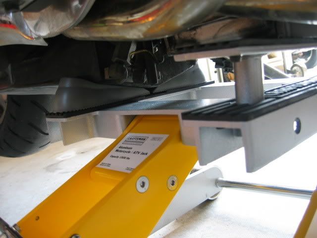

Can a m/c jack and the e-bay lift adapter be used with the belly tank mounted?
98 T
Posts: 649
'98 Tourer
Brookfield, WI
Re: Belly tank and lift ques.
March 04, 2009, 06:02:04 PM »
Frosty.
You can't lift with that adapter... Roger told me to use heavy vinyl door stoppers with a regular motorcycle jack.
There is a little wobble to it, but the tank is so stout, you can lift it by that.

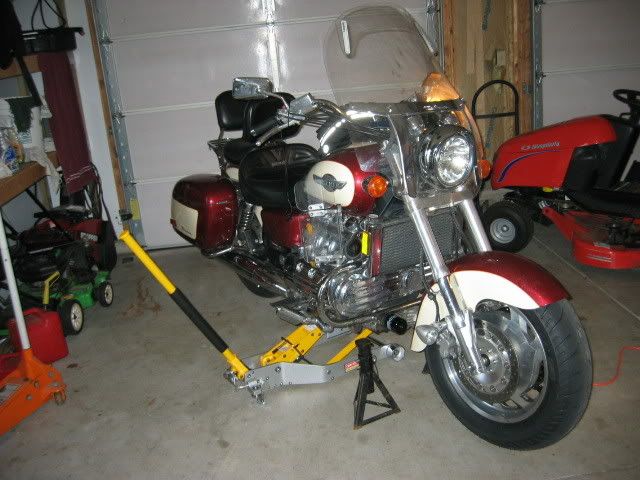

March 04, 2009, 06:03:22 PM »
Here's another shot....

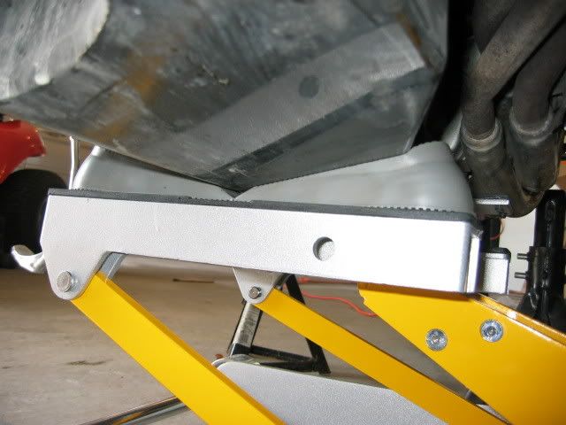

March 04, 2009, 06:04:58 PM »
[/img]
