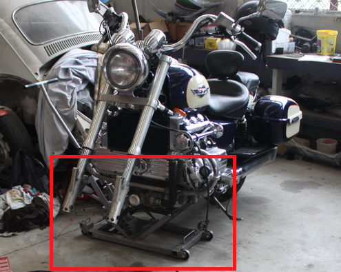

 Must be spring over here, a short ride in the evening and this is the result

Leathel, just had to ask, is that a scissor lift? If so, is it better than the lifts with the folding parallelogram? I mean does the arms stay level from bottom to high elevation?
not a scissor lift, just bad lighting so hard to see its a std lift.
