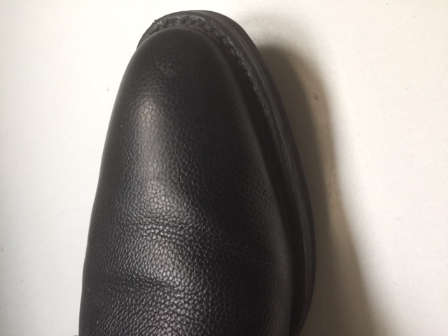

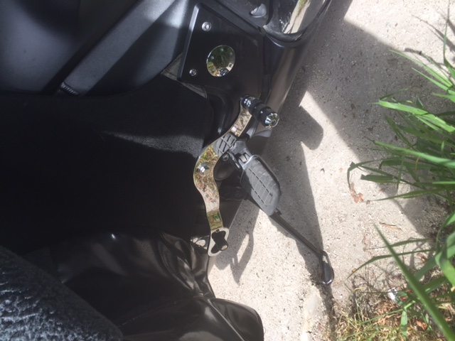

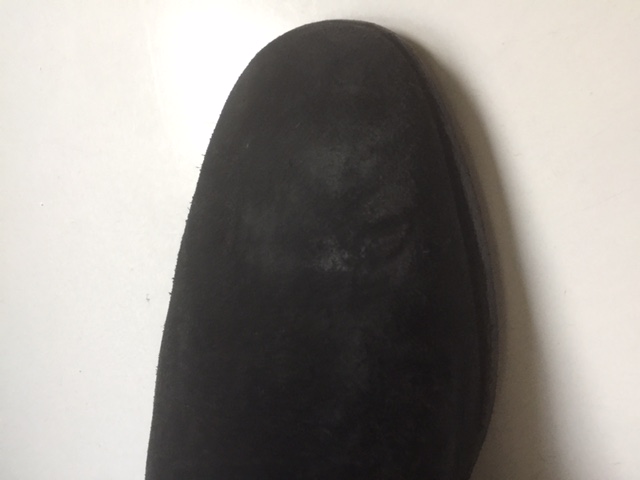

Sorry it's upside down  Embarrassed
I have this now on my bike, first time ever and I love it. After all these years using bike boots as rarely as possible, my left foot is painful because of the gear shifter on the foot. Since I have this heel/toe shifter, my foot is as bad BUT not getting worse (I hope) AND my nice shoes are not worn out anymore.
Before :
The only difference I see is that finding neutral may not be as simple as before, it's not a big deal though.
After :
The only difference I see is that neutral may be a little difficult to down shift (sometimes) but it's not a big deal. Of course, shifting is not as quick as before but with the Valk, does it really matter ?  angel
