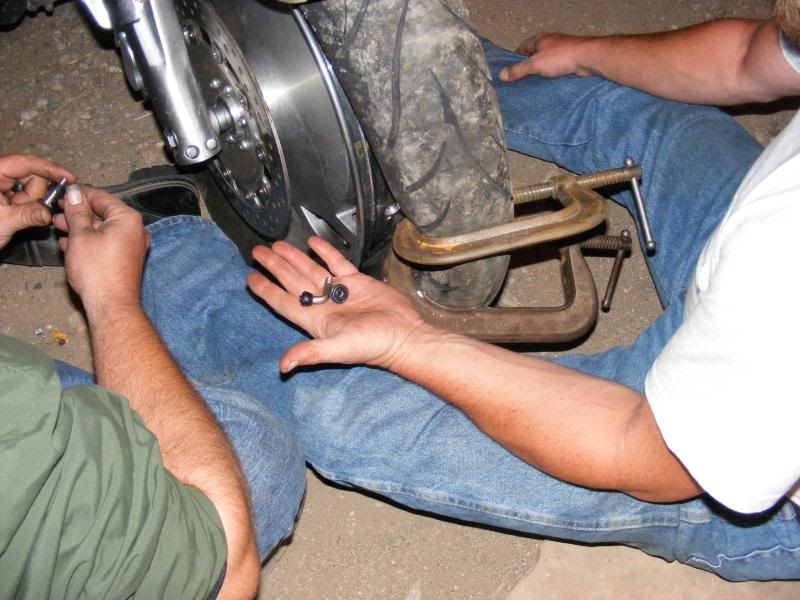

Really you only need to break the bead on one side to replace a valve stem.

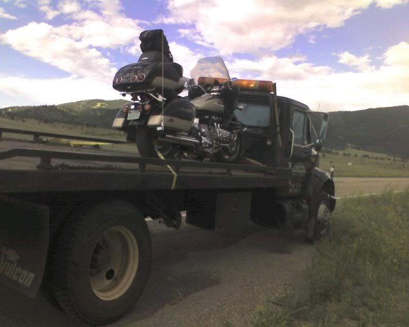

BTW... If you have the 90 degree valve stems make sure you either use the all metal nut type or carry spare plastic supports. The centrifugal force can cause the rubber seal on the factory stem to tear at the most inopportune moments (Like Wilkerson Pass Colorado in the switchbacks) Then you end up like this...
A couple of C - Clamps and a small air compressor will break the bead and allow access to replace the valve stem (Although it is very hard to find a 90 degree stem after the streets have rolled up in BFE, and a straight stem is a PITA to get air to) It will get you back on the road in a pinch.

Thanks Gunslinger, I've been there,  I don't have any pictures to prove it. My mistake was putting OEM valve stems back in uglystupid2 Now I just want to replace them cause I know better. That was NOT a pleasant experience for me. Don't care to repeat it.

 Grin The Patchboy valve stems came today. Thanks for the heads up (Gunslinger) , with the CT I broke the bead with (3)  8" C-Clamps, after removing the core (Ferris- which I replaced day before to rule out) The new Patchboy was a breeze  cooldude. Since I had the bike on a jack , I replaced the front one also in 15 minutes. QUESTION..... Has anyone ran into trouble with these valves? I'm going to carry a spare, it's definately do-able with C-Clamps in a parking lot.

My pics were taken in front of our rental cabin in Colorado shortly before Inzane, lol
An actual parking lot would have been nice. If a person had the c-clamps, a spare valve stem and a compressor I think it could be done on the side of the road.
