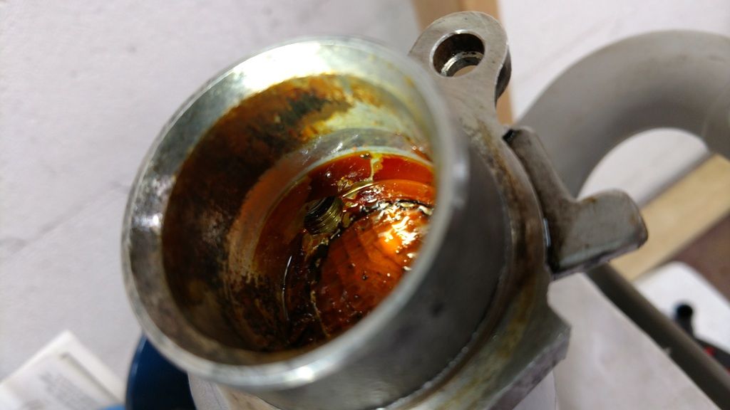

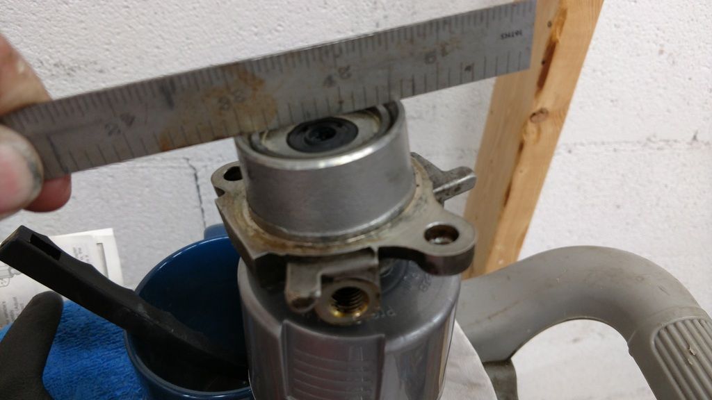

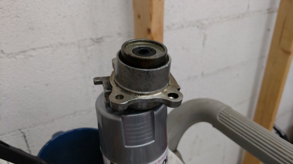

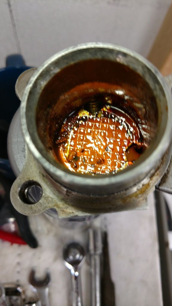

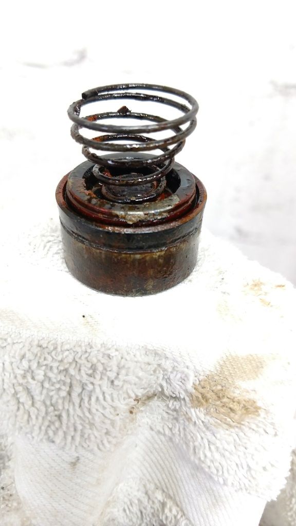

It was the slave cylinder.
When I went to loosen the three bolts to remove the slave cylinder it had spring pressure on it till it was about 1/4 " out,
I removed the cylinder but could not get it apart. I even tried 120 psi of air pressure. The way we did it at Firestone back in the day.
So I reinstalled it and bleed the slave cylinder.
I used master cylinder to try to push the piston out of the slave cylinder.
It worked but it took a lot of force with the clutch handle,
You could feel it jumping and binding all the way out.
Then I pulled the slave back out again and the piston was still stuck with the seal half out.
It piston came out with a little air pressure.
All I can figure out was the slave cylinder had built up so much crud that when I bleed the clutch I forced the piston forward into the crud and bound the piston to the cylinder.

« Reply #10 on: May 07, 2017, 04:56:14 PM »
Slave cylinder when removed the first time.
 http://i164.photobucket.com/albums/u15/57daze/Repair%20Valkyrie%20Clutch/slave%20cylinder%20as%20removed.jpg

« Reply #11 on: May 07, 2017, 05:00:17 PM »
I'm checking prices on a new slave cylinder now.
I've got the old cylinder soaking in some purple power to see if it will clean up.

« Reply #12 on: May 07, 2017, 05:07:12 PM »
http://s164.photobucket.com/user/57daze/media/Repair%20Valkyrie%20Clutch/piston%20removed.jpg.html?o=1
Posts: 6795
« Reply #13 on: May 07, 2017, 05:12:04 PM »
Because it was stuck, bleeding made no difference.  I've never had to work on a slave.  I see now, it doesn't seem to matter if the slave is working or not, the system will still bleed.
The manual states to check for scoring or damage on the slave, weakness or damage on the spring and wear or damage on the lifter rod.  I wondered if they listed size specs, but seems it's not a wear item like caliper cylinders.
It's cool you found it and doesn't seem to be any expense. cooldude

« Reply #14 on: May 07, 2017, 05:35:23 PM »
[URL=http://s164.photobucket.com/user/57daze/media/Repair%20Valkyrie%20Clutch/piston%20removed.jpg.html]
[/URL]

« Reply #17 on: May 07, 2017, 08:04:43 PM »
Thanks guys!
I'm glad it was not the clutch or the drive line.
I went back out and pulled the parts from the cleaner and rinsed the parts.
With a little cleaning ever thing look reusable. Cheesy
I'll run a brake hone on the cylinder  tomorrow.
I'll dress up the piston with some emery cloth.
The only hold up will be if the local Honda dealer has a seal for the piston seal.
With luck I should be back on the road soon.
