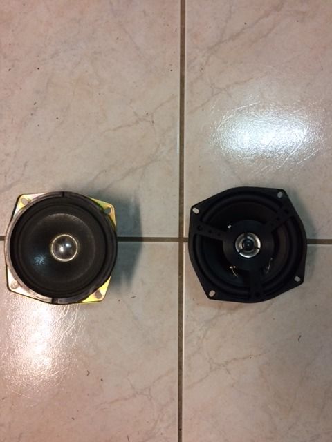

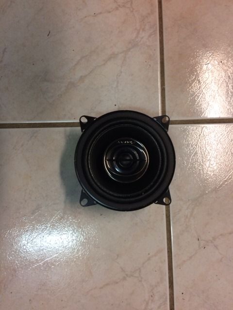

Are the speaker original, if they are they don't like water on or in them. I just installed water proof speakers and a 300 watt amp in my interstate. I Like my country and disco loud.  Shocked
Front 4.5 inch & rear 4 inch.

Hey Steel............... what type of speakers and amp?
Steel cowboy
Posts: 1291
Spring Hill, Fl.
« Reply #9 on: June 09, 2017, 03:11:44 PM »
Speakers and the amp are all water proof
front speakers came from amazon they were "Show Chrome" 4.5"
rear speakers I purchased at "Best Buy's" they are Pioneers 4"
amp was from Amazon 300 watt with volume control ( limits the amount of amplification)
