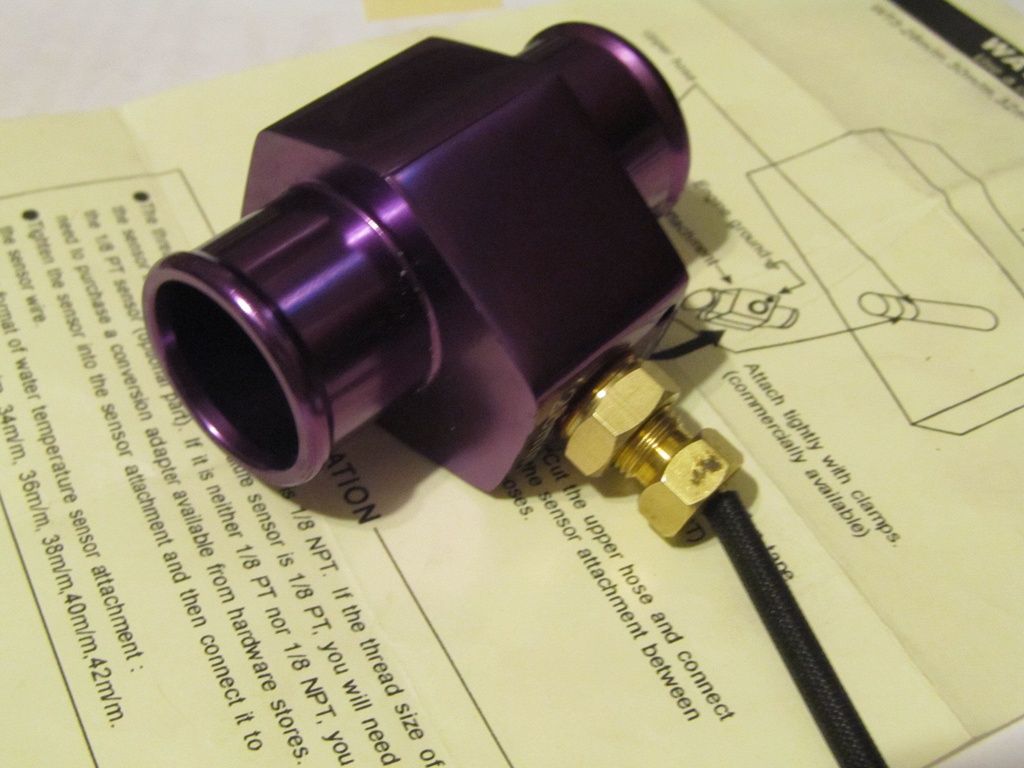

Now that temps have stabilized at 110F  Roll Eyes, time to get ready for our annual Hack trip back east.
Last trip a failed water pump cooked our GL1200 Hack; wouil dlike to get a temp gauge installed, that has been sitting in the parts box for too long...
Anybody have a hard time sealing the sending unit to the adapter?
Have the "Glowshift" adapter, with 1/8" NPT threads.
Have a KOSO digital thermometer, with 1/8" sensor pipe threads.

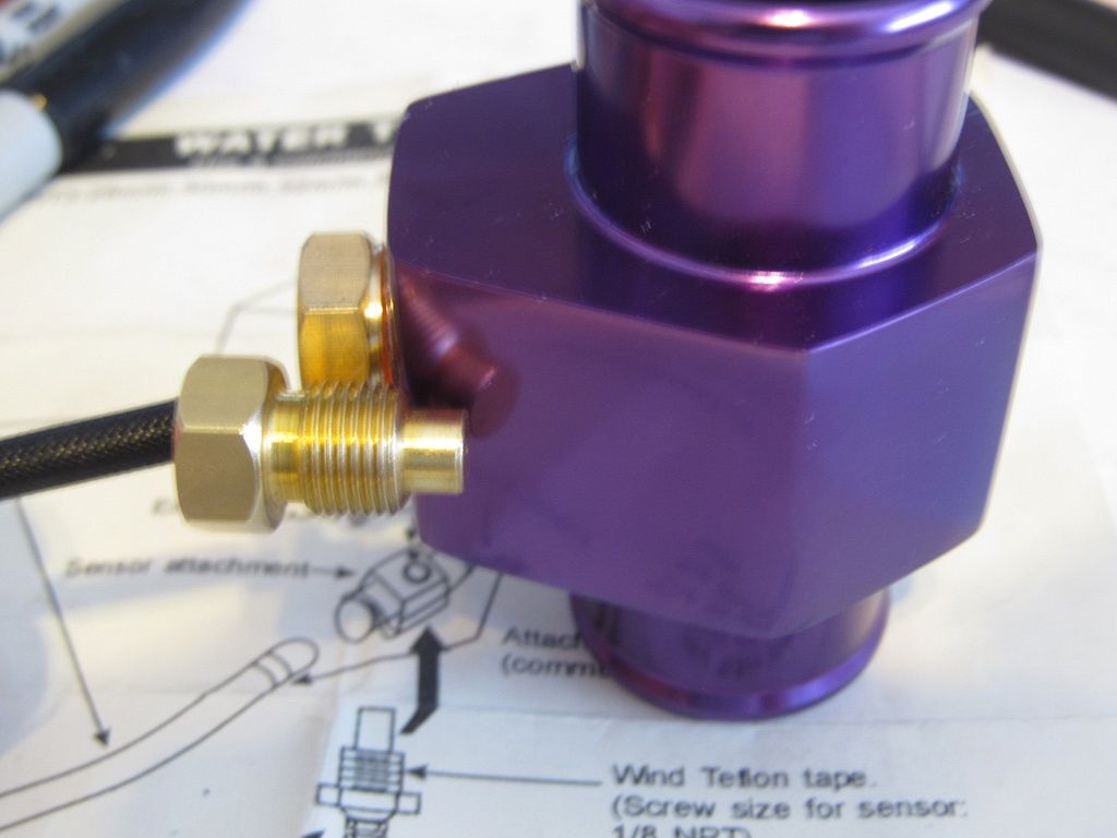

The KOSO sensor screws all the way into the Glowshift adapter.  Doubtful it will seal.

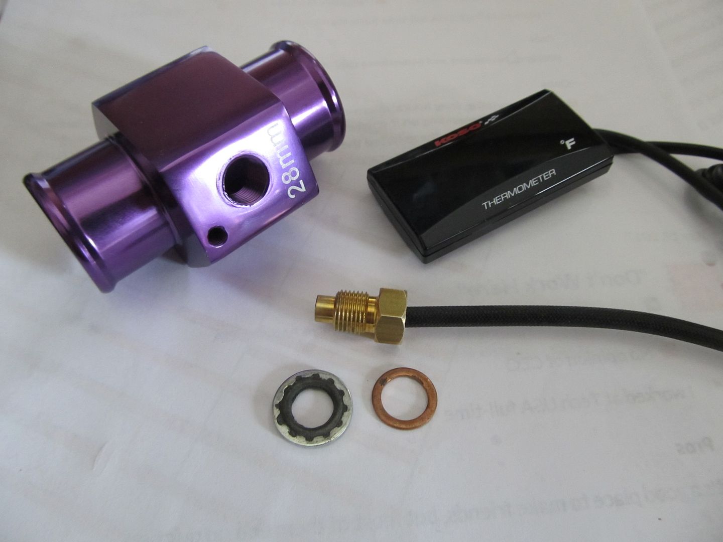

Unless I maybe put a crush or sealing washer on it, as shown.
Anybody fought this battle and won?  Other than
1) Grinding off the adapter anodizing, welding up the hole, and tapping 1/8" pipe threads, or
2) finding a new adapter with real pipe threads?
I've already got the gauge, and it matches the voltmeter; so I'd rather not buy a new gauge.
TIA
oldsmokey
Posts: 354
Mendon Massachusetts
« Reply #1 on: June 24, 2017, 02:52:17 PM »
So the original thread went too deep? can't benefit from the tapper? Blue Monster thread sealant is good stuff. Maybe thread tape. Guess it depends on how sloppy the threads are Undecided No real pressure in the system it might work.

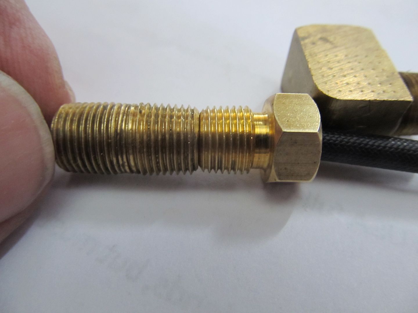

Correction.
The KOSO sensor is NOT pipe threads, as can be seen by the next pic.
That said, real 1/8" pipe fittings screw into the adapter almost to the root; way deeper than a 1/8" pipe male to female connection would be.  Guess they just machined the adapter to allow more threads of a pipe fitting to be engaged.  Odd though.  I've never seen a pipe fitting ...almost... bottom out.
Yea, I know it ...might work.  But I was looking for a response where this actually worked...  I've been burnt before by trying to jury-rig (there's a word not heard much anymore...) something, it works for a bit and then fails leaving you stranded on the side of the road in BFE.
I'm now thinking of tapping the adapter out to 1/4" pipe, then finding a 1/4" pipe to 1/8" BSP adapter.  I think I've determined that this (BSP) is the thread type on the sensor.
Why is this such a pita???  What's wrong with pipe threads???

You might try an O ring that fits in the non threaded groove under the hex head. Spec it for heat (viton/silicone) and don't over tighten it. Cooling systems are under 15 PSI as you probably know.

I've had that type of adapter on my Valk for at least 10-12 yrs. with no trouble. Mounted it in the upper radiator hose where it goes horizontal before hooking to the radiator. You can use just about any good sealer since the smaller hole shown is for a grounding wire attachment. I've never had a leak....so far.  cooldude  I used an Autometer C2 gauge on mine.

I don't see any provisions for grounding the adapter. Maybe the sensor cable carries the ground. If the adapter needs grounding, make surer provisions are made. The rubber hose ain't gonna take care of it. cooldude
Revision
I see John has already mentioned some of my concerns. I see now the grounding provision on the adapter.

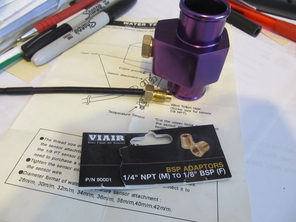

Found an adapter - 1/4" NPT to 1/8" BSP - on Amazon.
Drilled the hose adapter for the 1/4" NPT, and tapped it deep. Screwed in the adapter, screwed in the sensor.  It all fits well - kind of.
However, the sensor is now out of the hose cross-sectional area by maybe 1/2".  I'm thinking this should still work - although with the sensor in a "hole", it may not react as fast as if it were directly in the cross-sectional area.  I will be mounting it facing "down", so am not too concerned with a air pocket.
I can still put a plug in this thick-wall area of the hose adapter and tap the other side.  The material there is about 1/4" - it should work.  But the sensor would still be out of the waterflow area by maybe 3/16 - better than 1/2"...
