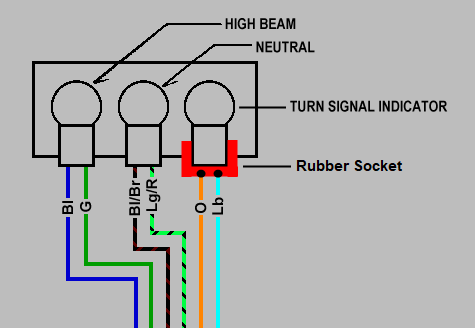

You're pulling the indicator bulb out of its indicator's socket, then shove the bulb-less rubber socket back into it's recess for safe keeping. Un-plug n' play, if you may. If by chance you're inquiring how to gain access to the indicator bulb, itself, you'd have to access the plug from within. Again, when you pull the bulb out of it's socket, this disables or eliminates the circuit that's causing the 4-way flashing. The idiot light is a tributary off the turn signal circuit, a simple monitor. As such, disconnecting the idiot bulb won't stop electricity flow in the turn signals' circuits, but it'll stop cross-over current not suitable for Led bulbs.
Btw, if you look at the graphic below, cross-over current will always be present at the turnsignal's idiot light with the way the oem wiring is configured, when signals are activated. If you had a separate idiot light for the right signals & a separate idiot light for the left signals, each idiot light would have a Ground wire to complete the circuit. With a single idiot light, serving both sides' signals, the wires for the non-activated signals function as the Ground return. True, this means electricity is flowing through the non-activated side's signals, but the bulbs won't light up if the bulbs are incandescent, as explained previously.
