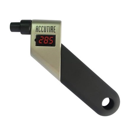

My "ride day routine" starts with a digital gauge.
Years ago, first time I did an advanced MSF course with my own bike, they did safety inspections before hitting the classroom to get started. When asked when tire pressures were last checked, most answered vaguely - "couple days, couple weeks, or I don't remember".
My response? "What time is it?"
