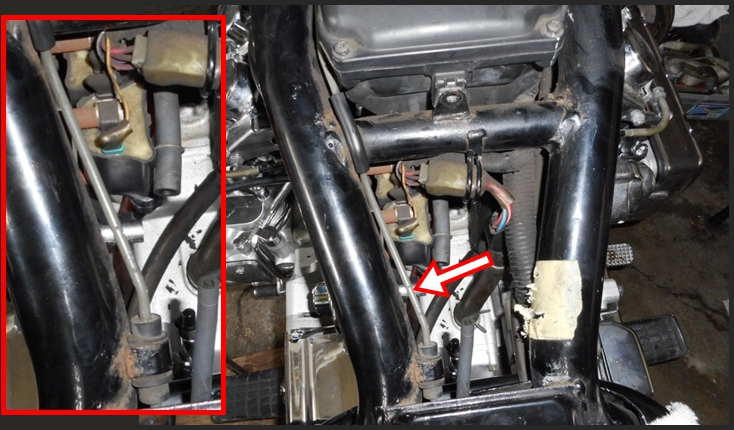

« Reply #9 on: September 20, 2017, 11:04:07 AM »
Try avoid hitting the clutch hydraulic line (arrow). The petcock catches it.
