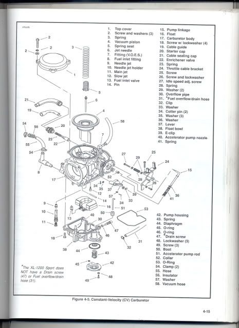

I would like to see an exploded view of my blower bikes Kehin Carb, maybe JK, Fstsix, or someone could help me or give me some info on where to find one? THX in advance

http://www.gadgetjq.com/keihin_carb.htm
http://i287.photobucket.com/albums/ll126/kozmic1520/explodedcv.jpg

JK what number part is the O ring on the jet that a guy should replace when the fuel regulator over rides it resulting in raw gas puking out. I am thinking I want to replace it due to the oxygenated corn fuel corrosion my state makes us all run.

#13 is all that holds back the fuel from the bowl. It could have gotten trash under it, or the pressure was too high. I've never need to replace one.

 may I ask if under the float valve you refer to as #13 is there any rubber material such as an 0 ring that #13 seats into or is it metal to metal? Does the taper on #13 have any rubber like material on it that could deteriorate?
I am fishing for info so when I take my carb off I can replace #13 and any 0 rings etc; to reduce the chances of gas spilling out on my engine since my fuel regulator is set correctly and if I find no foreign matter under the needle and seat I want to replace everything that has anything to do with gas overflowing out of the carb? THanks in advance

#13 has a rubber tip

Thanks Jeff, my bet is the corrosive oxygenated  fuel that make us run here has possibly eaten at the rubber on my tip since my blower bike sits all the time so I will just replace this needle part.

Heck it won't take an hour to pull and clean the carb go for it. Just for the piece of mind if nothing else. Be careful of those bowl screws they are cheap and easy to round out. Use your "good" Philips screwdriver.  Wink
Just be careful not to bend the tab and ruin the float setting.

Thanks guys, I agree pulling the carb is not a big job, I have a rebuild kit coming and I am going to change out the needle valve.
JK where can I get the carb screws as I understand what you are saying about the bowl screws they are really soft and round out very easy. I know when we were tuning and trying different jets the bowl screws are touchy.

Any hardware store. They are not metric but I don't remember the size.
