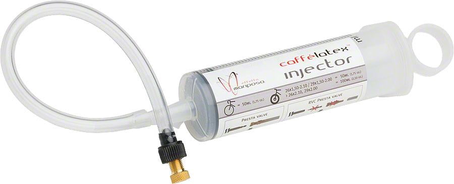

I put ride on in my tires with a mountain bike tubeless tire goo filler...
