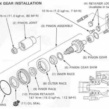

SO........I have all the parts and had to wait  since I thought I had the 3 O-rinds in stock but did not. While ordering them, I also thought to re-order the u-joint boot since the bike is 20 years old with 92k on the clock. what I cant find is a torque spec for the pinion joint cup. Anyone know that one?

« Reply #5 on: December 08, 2017, 10:38:34 AM »
Click on image.
Honda Valkyrie F6C Service Manual
http://valkyrienorway.com/download.html
