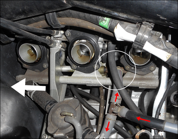

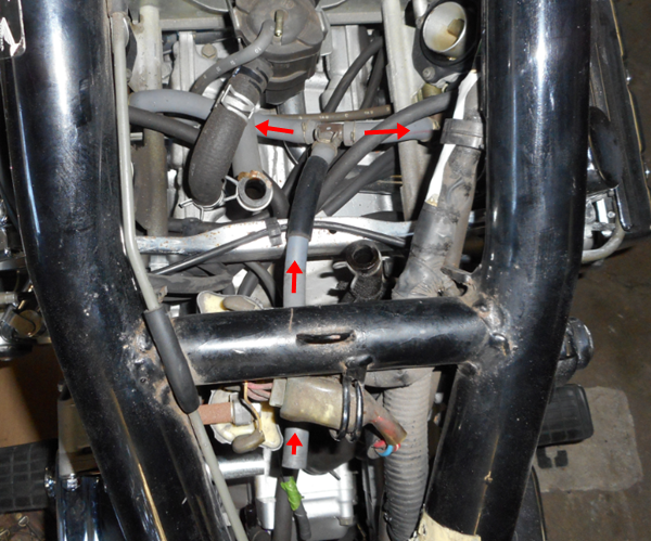

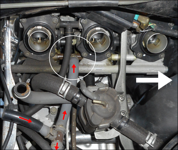

« Reply #5 on: December 10, 2017, 08:38:24 AM »
I can't tell for sure where it is leaking, I have only removed the Petcock switch on the left side to check the fuel line.
  • It [the fuel hose] isn't seated all the way against the Petcock housing but it doesn't appear to be loose enough to be the leak problem.
My fuel line is seated as circled below, so you're in good company or we're both hanging on by a thread. You know all that wrestling you do with the fuel tank trying to disconnect the fuel hose from underneath, that pulls on the tee or the hoses attached to the tee, and that stresses the o-rings, so it's probably a good idea not to pull on the fuel hose more than necessary as it is. Probably gain only ⅛-inch anyways.

Yes I rebuilt the Petcock but I rebuilt exactly like the one that was already on there and it was pretty much a group decision that the one that was on there had already been rebuilt backwards.  I ended up replacing the Petcock with another OEM Petcock.  So the petcock on it now is new and seems to work correctly it does at least shut the fuel off.
Thanks for the pictures, I've had my bike torn down to the point I can see the same thing you see in these pictures.  My fuel line is seated about the same but If I recall I couldn't get that clamp over the hump so it is just gripping the end of the fitting.
