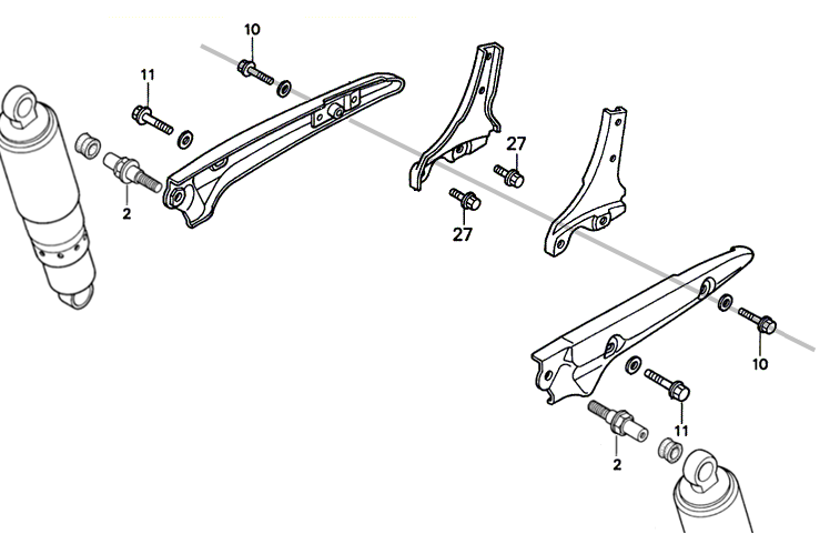

New to this site and Valk. Picked up a low mileage 01 Standard a couple weeks
ago. Would like to remove the passenger backrest side brackets. I know the rear strut bolt runs
through it. Does the front bolt also?  I couldn’t find the removal process on the forum.
Any “how to” advice is appreciated.

It's been awhile, but I believe the backrest brackets bolt to the inside of the grab rails.  To remove them you have to remove the grab rails, to remove the grab rails, you have to pull the bolts that hold the rear section of the fender on, with the famous PITA fender nuts in the nut cages.
You also have to pull the shocks, maybe just the top.
I'd suggest doing one side at a time.
Another solution is to find the chrome bar that attaches to the brackets, making them look like they belong.

After I removed the rear bolt, I could tell the bracket was secured further up the strut.
The location of the rear bolt does throw you off, but the sissybar bracket and fender rail have no connection to each other. The rear bolt goes under a notch in the sissybar bracket instead of going through the bracket (gray line, graphic below). The bracket is attached to the obverse side of the fender rails by blind bolts 27 (graphic, below). You have to remove these bolts to disconnect the saddlebar bracket.
There was an easy method that spares you from removing the shocks, off hand, I don't remember the specifics but I assume it's something like ..... remove the rear bolt and the middle bolt, then loosen the shock bolt just enough to allow the fender rail to be rotated up to access bolts 27, or loosen the shock bolt just enough the slip a wrench behind the fender rail to loosen bolts 27.

I removed the rear strut bolt and loosened the front one enough to span the
rear of the strut. I was able to remove both bracket bolts with a 12mm wrench.
Each side took about ten minutes including putting it back together. I masked the
fender with painters tape to guard against the wrench coming in contact with it.
I wish all wrenching was that easy!
