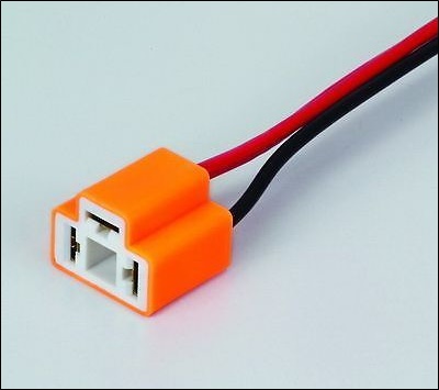

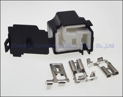

I'm gonna replace the oem plastique plug with a ceramic plug (below). There's some discoloration on the plastic plug. Not a huge concern but just to keep on the safe side. Previously, I've ordered the wrong type plug that were not designed to plug in the oem flag terminals (second pic).
