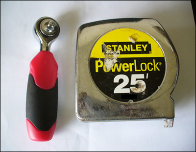

Bareass has an excellent tutorial. He is also one of the best writers on the Internet.
In order to slip the spring seat stopper out, you have to push down the spring collar against the coil spring pressure. I've found it easy to do with a ΒΌ-inch ratchet (2nd pic).
