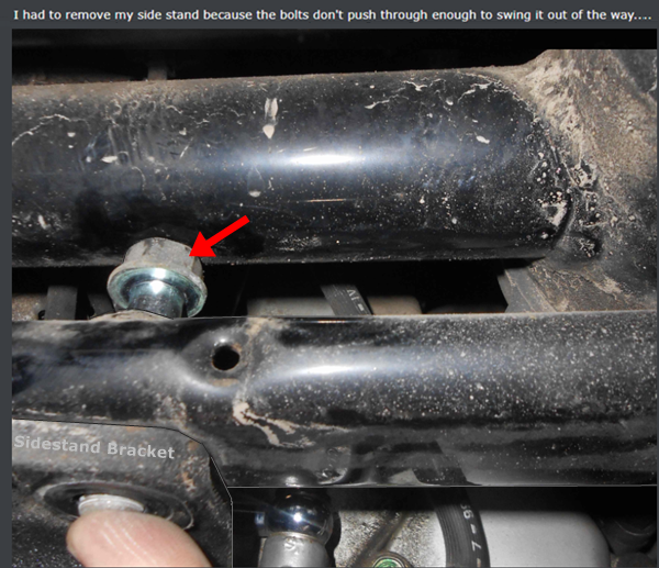

I had to remove my side stand because the bolts don't push through enough to swing it out of the way...
After that its simple, drain the system, loosen the bleed pipe oil nut, remove the bleed pipe retaining bolt, remove the clutch pipe oil bolt and the three slave bolts and remove the slave.
Inspect the piston, seals and spring for any abnormalities or wear and tear... This one is in perfect condition so I put it straight back in and bolted it all back together - Job done!

Savago, you might wedge the bolt up with a horse shoe (slotted wedge). The bolt's protruding end is a nuisance even after removing the sidestand bracket. Gets in the way under there.
On the bleeder pipe, I didn't loosen the banjo bolt per manual mainly becuz it woulda been hard to torque it back to specs. Just have to slacken the vent tubes etc. enough, near the top end of the pipe to finagle out the slave assembly.
