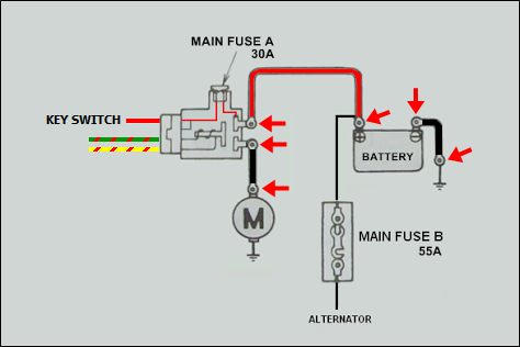

You do realize if either one or both of your battery connections is corroded or loose and you apply power, you can also get a pop from there!? Likewise the ground connection on the engine itself.

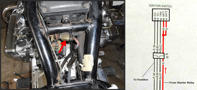

Since you say there is power at the fuse block the main 30 amp fuse has to be good.  The ignition switch Provides 12 volts to the fuse block on 3 separate wires.  Blue/orange, red/white, and red/black. Do you have 12 volts on all three?  Also if you checked the fuses with the ohm meter with the fuse still installed, remove them and check again with them out.

I don't have any power at all to anything. Got power to main fuse block and to starter relay, could the ignition switch be bad and cause this or how to check it,

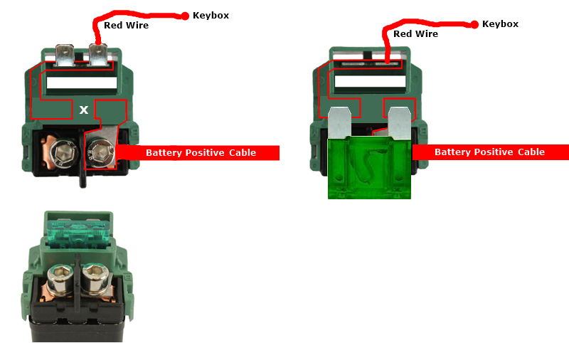

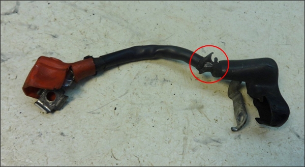

I had the same problem, and ended up going through the ignition switch. Taking apart the ignition switch isn't difficult but it's not the culprit to the total lost of power, and maybe not worth your while. You might try inspecting the battery cables and crimps under their wrappings (pic below). You can take voltage readings on the ignition switch wires at the 4p-connector under the plastic boot (red arrow, 2nd pic) which spares you from disassembling the ignition switch if the voltages are up to par. The Red Wire is the +12 power source for the ignition switch. Then, the ignition switch powers the fusebox downstream. A few more tidbits on the red wire in the paragraph below.
The Red Wire plugs into a blade terminal in the green thingie atop the starter relay. The red wire is connected to the starter relay's battery(+) post via two aluminum plates that are encased in the green thingie. Of course, you can't see the encased aluminum plates but the aluminum plates are outlined in red in the left pic below. The two aluminum plates have a Gap X between them. The main fuse bridges this gap. When the main fuse is plugged in, the red wire becomes connected to the battery and is a live wire and remains a live wire even when the key is OFF. Fortunately, the red wire only goes to the ignition switch. It doesn't have branches to serve other devices either.
