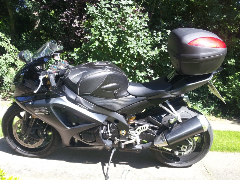

ledany
Posts: 509
Paris, FRANCE
« Reply #6 on: February 23, 2018, 11:08:09 AM »
Tss tss Bill ! I'm a really cool rider, see how I equipped my GSX-R !  2funny
