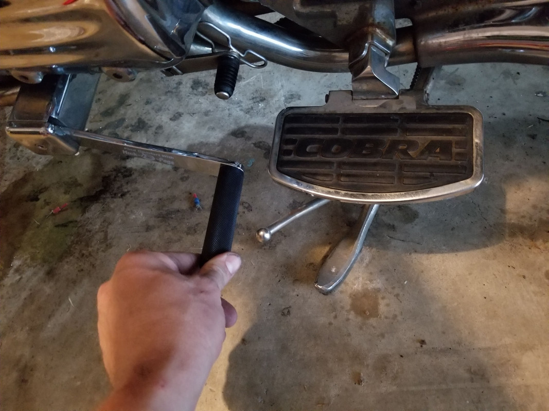

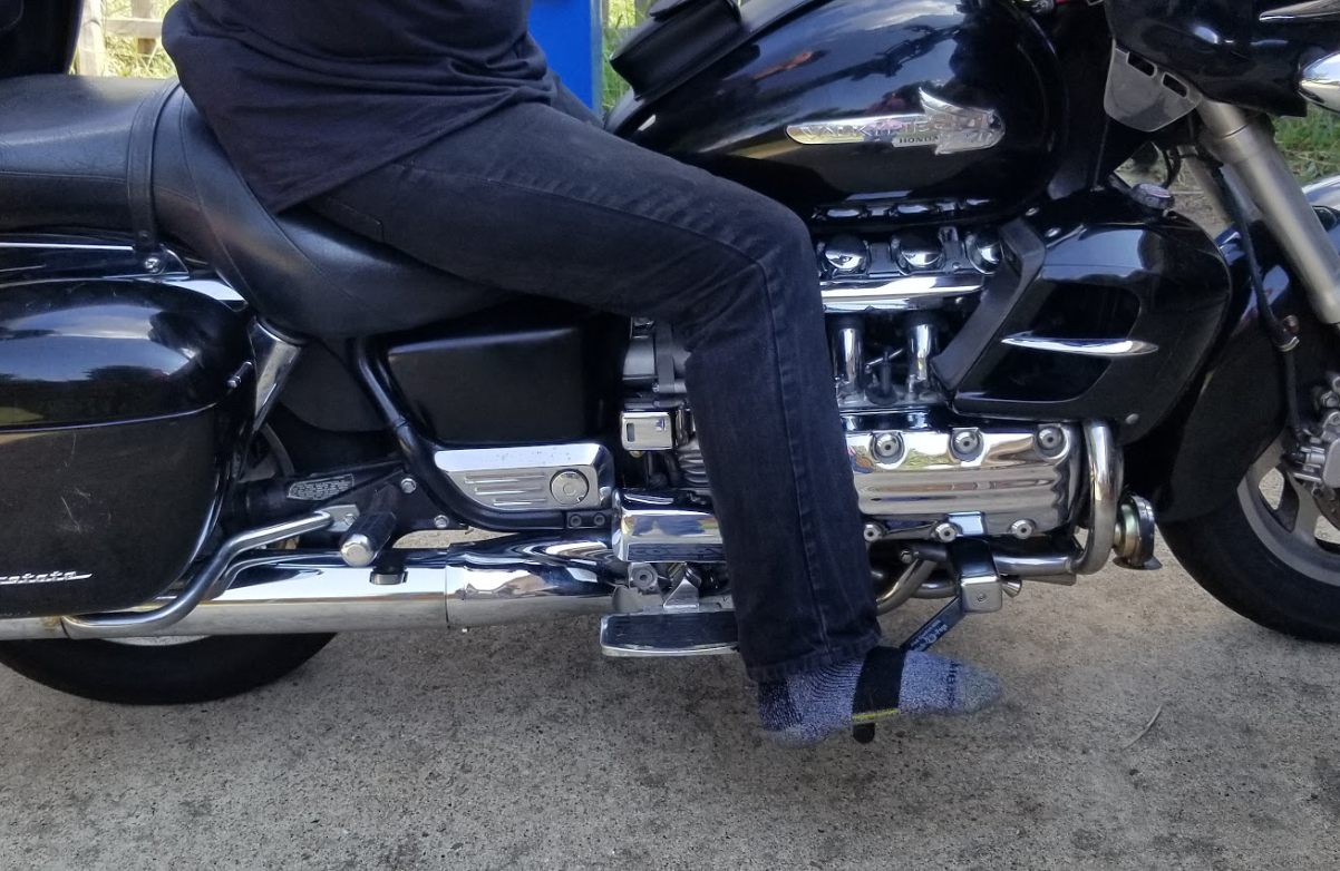

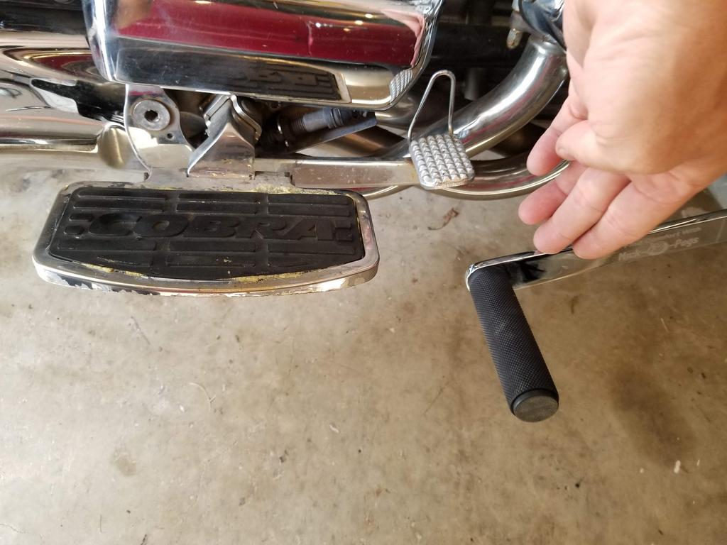

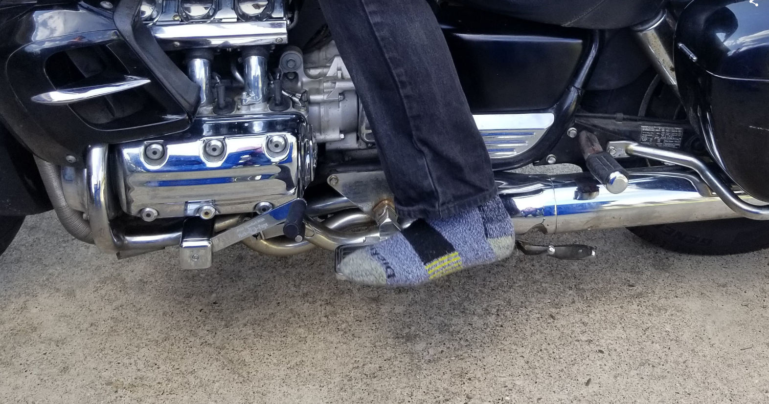

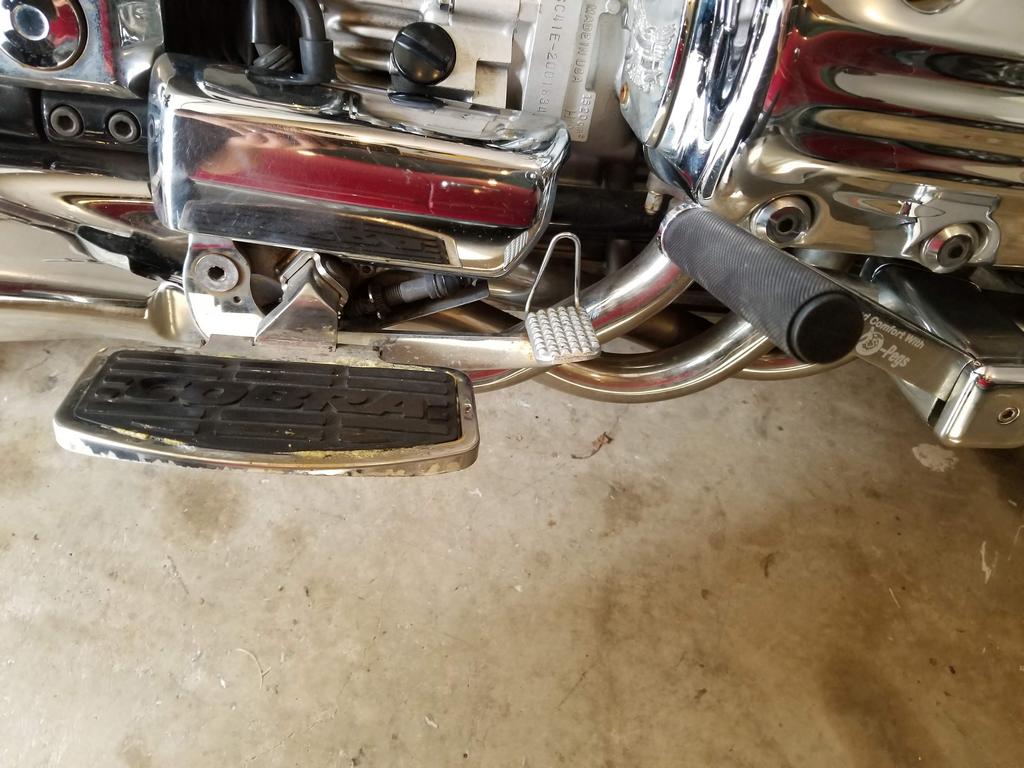

Why didn't anyone tell me about these Mick-O pegs before?!?!?!
(Kidding, I've heard them mentioned many times, never thought they could be THAT good... They are!)
Got 'em, got 'em installed and took a quick ride around the neighborhood (Barefoot no less, I was in such a hurry to try 'em out) and oh my, where have those been all my riding life?!?!?!
Edit to add - Anyone know why the directions tell you to disassemble 'em before installing 'em? That was totally unnecessary as far as I can tell, at least on a Valk install?

« Reply #27 on: August 04, 2018, 09:50:58 AM »
How about a couple of pic's of the pegs, up and in use? Socks optional.
Posts: 22097
« Reply #28 on: August 04, 2018, 03:42:15 PM »
Left side with Mick-O Pegs stowed:
Left side with Mick-O Pegs deployed:
Right side with Mick-O Pegs stowed:
Right side with Mick-O Pegs deployed:
Cracker Jack
Posts: 559
« Reply #29 on: August 04, 2018, 04:10:06 PM »
Looks like your pegs are mighty close to the front of the floorboards as is mine. I have my floorboards as forward as possible on the peg lowering plates and the Mic-O -Pegs as far forward as possible without cutting the scoops off.
So far, doesn't work for me as the boards hinder the deployment of the Pegs then hit the back of my legs when deployed. I have considered cutting the Mic-O-Peg arms off a few inches to give more room. They really don't need to go as low as they do nor raise up as high as they do. Shortening the arms will restrict the up and down limits but I don't see that as a problem.
I don't recall anyone mentioning that as being a problem for them. cooldude

Posts: 12879
« Reply #31 on: August 04, 2018, 05:46:44 PM »
mine are also all the way forward
thought about cutting the side of the scoops but didnt
I've been a little concerned, since my peg lowering kit hasn't arrived from Poland yet. But so far, and I took my first real highway test ride with 'em today, the Mick-O pegs are awesome enough I will MAKE them work, if the peg lowering kit and the floorboards interfere with the Mick-O's, I'll swap the floor boards out for regular OEM foot pegs to make it work.
Most of my height is in my legs, so I really wouldn't wanna shorten the arms on the Mick-O's any, I want as much length as I can get to stretch my legs out as much as possible.
My Mick-O's are also as far forward as I can get 'em without cutting bits off the bike. So far this looks like it will work, especially once my HartCo custom seat comes in which should lift me up and back a few more inches from the stock seat. From the pics it doesn't look like my feet are moved very far from their position on the floorboards, but from riding it those few inches make a WORLD of difference.
I'm impressed enough with the Mick-O's, once the dust settles I'll probably be getting a second set for my other Valk... (It's nice owning multiple Valks, but dang it can get expensive putting all the necessary farkles on both of 'em! I've put almost the price of a used Valk into my new one just to make her mine, and I'm not finished yet, but I knew that was coming and have zero regrets... )

My question is, would those pegs mount further forward if you cut the scoops off?
In your picture, it looks like you are holding the arm down a little.  It looks like the Micko peg would sit nearly even with the shift peg when at rest, and possibly interfere/impede toe movement to the shift peg.  Maybe it's just the angle of the shot
I'm pretty sure it could be moved further forward if I were to hack the scoops off, but I'm okay with 'em where they are, at least so far.
I am holding the peg down in the picture, I was trying to hold it in position as close to the front of the floorboard as it could get. In the "resting" position it's pretty far up from there, next to the engine itself. I'd go get a pic of it in the resting position, but the bike's are all snuggled up in the dry garage and it's raining again.
This pic is from a few days ago, before I got my peg lowering kit, and from the brake side, but gives you an idea of where the pegs sit in their non-deployed state:
