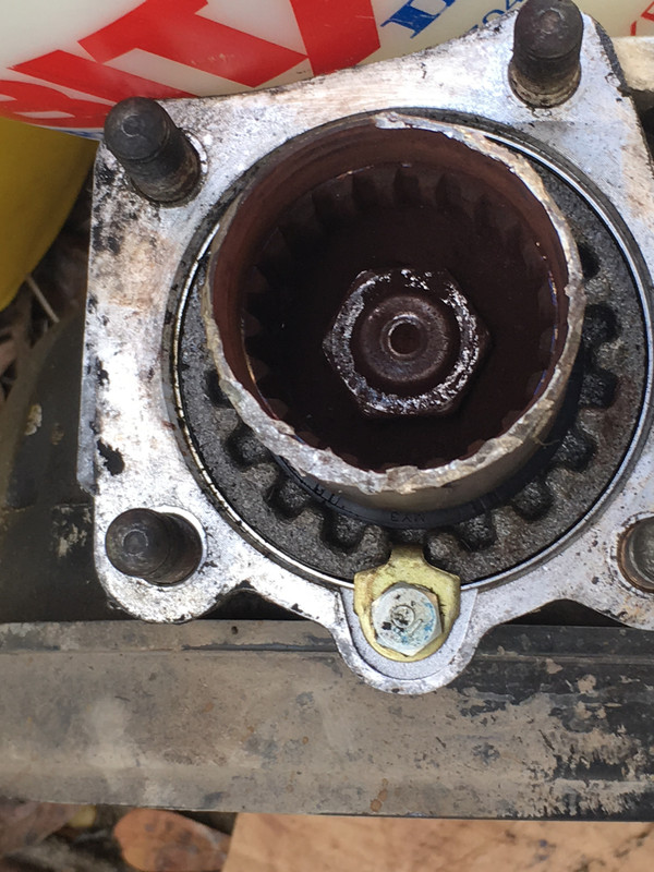

The first indication of ‘boo-boo, aw-shucks, dang!’ was that fine, rust-red colored dust puffing out from behind the shaft seal at the rear pumpkin when effort was expended to pull the shaft out. Oh no! I’ve seen that awful, dread-producing ‘puffing’ before, and it was never followed by good news!!!

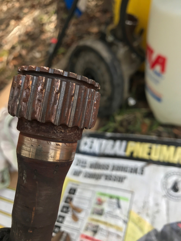

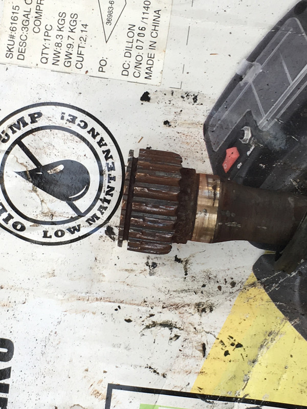

Once removed, the shaft was inspected and noticeable wear among the splines was clearly evident both on the shaft itself and in the pinion cup… virtually no grease remained there where it had been liberally applied on the last inspection, perhaps 18K miles or so before!

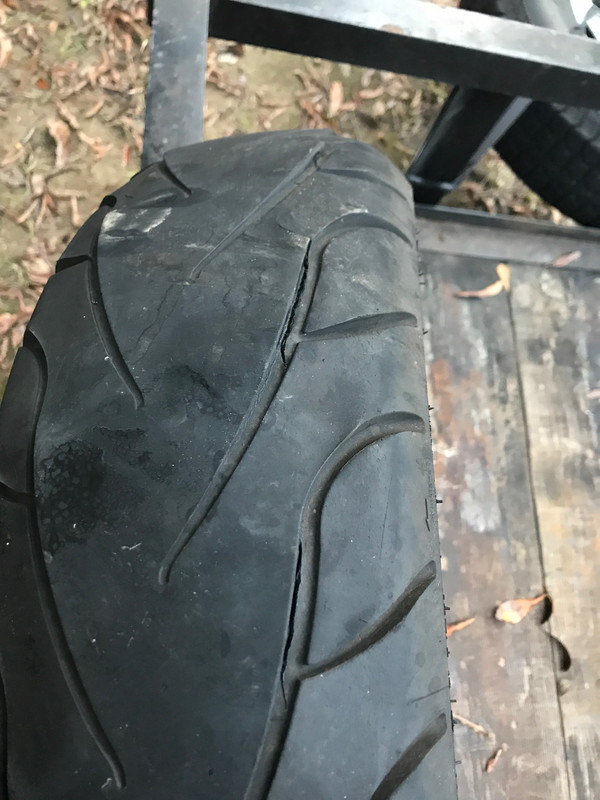

The rear tire was also replaced, and the old tire closely inspected… then, more aw shucks!!! Cracks, not previously detected through routine eye-ball inspections while inflated and mounted, were clearly evident and abundant down in the tread! There was still ‘meat’ on that round, rubber, compressed air receptacle, as amazing mileage had been obtained on our girl over the last couple of years since switching to that particular tire… Michelin Commander II…
The least miles we’ve gotten out of one of those rear tires has been 30K on the first one. The most was 35K on this last one… We’ve never noticed any cracking before, even after removal, but this time… alarm bells sounded loud and clear! Timing for this replacement may have avoided an absolute calamity a short time later!
After the removed tire had been cleaned off a bit for closer inspection:
free screenshot tool
screen shot on pc
Dennis made me take an oath never to run a bike tire that far ever again! From now on, 30K tops, with 15K close inspections at regular rear-end servicing… and to religiously maintain air pressure above 40psi. About that rear-end… The left rear wheel bearing had gone out earlier this year, and Dennis had replaced that following our rescue from Russellville, AL. He’d also inspected the shaft and pinion cup splines and applied new grease…
This most recent inspection had come about 18K miles since that last lube job, which had been applied at the time of the bearing failure episode… The splines had been OK then, but continued wear was observed, as it had been on all previous inspections. We continued to use this shaft anyway to see just how long it would last.
Because we couldn’t be certain the fix a couple of years ago was the ultimate remedy, Dennis had installed a used drive shaft at the time… one that already had about 120K miles on it. Our thinking at the time had been, if the swing-arm replacement did turn out to be the long-illusive fix, then we could address the aging shaft issue, if and when needed, down the road at the next or some future inspection. If that wasn’t the solution, then we hadn’t wasted a new part due to our experimentation. That well-used shaft had served us quite nicely, but it was, alas, not indestructible…
This near failure was occurring following a total of more than 250K miles on that shaft! Inspection and re-greasing at rear tire changes had been sufficient right up until this last time; although, increasing wear on the splines had been noted. In the end, however, overall wear on that part had eventually taken its toll, and the inevitable failure was rapidly approaching… The shaft and cup were both replaced… and another oath taken to come by at 15K intervals for inspection and re-lubing in the future!
After wiping down for better visibility…
Dennis had found the swing-arm ‘vent-hole’ plugging issue on ALI back then, because he’d kept asking the question, “Why?” He wouldn’t rest until he knew not only what was wrong, but why that had happened, what was causing it, and, more importantly, what could be done to avoid, or delay, future recurrences.
The drive shaft and pinion cup had been toasted… but why? The grease had boiled out… Not because of improper prior greasing, as was previously suspected, but because water was getting to the cup via condensation inside the swing-arm, originally. How? From what source? What could be done about that? His dogged perseverance had paid huge dividends for our girl and her riding partner!!!
In this case, the ‘vent’ holes were free and clear, so we’re speculating that heat generated just from the severely and increasingly worn splines had been sufficient to boil the grease out without any water having intruded… Although not unanticipated, we hadn’t thought a failure would occur quite this soon…

Those cracks in the tread are concerning.
I'll have to keep an eye on the one that I mounted after you "talked" me into it.
If I get 20K out of the one that I'm running I'll be ecstatic.
Mark,
Yeah! Sphincter-tightening concerning!!! Hard to believe those ominous boogers were there! I've had remarkable service and mileage out of those tires, and I was comfortable with the idea of just using them every time the need arose. Another reason I've never gone D/S, is once I lucked onto these, I just never saw the advantage or need to justify the disadvantages...
We don't have a theory yet on what might have caused them... We did carefully inspect the new one installed, though, and at least we're starting out with one with no cracks of indications of a crack... Close attention will be paid, you can be sure, over the course of this tire's life... We'll see...
I can't imagine that you would get less than 20K out of your tire! At 20K, mine have always appeared 'nearly new'! Please favor us with a report on your experience... One caution I would add... be thoughtful when stopping on slick surfaces! Twice I've had one break loose on me while aggressively stopping. Once just after installation (less than fifty miles) on newly damp road and hard breaking for a stop light. Once on 'tar snakes', again, stopping aggressively for a stop light...
These tires must be a bit 'harder' than others in order to produce the high mileage... With that firmness naturally must come a wee bit less traction/gripping power... I hesitate to blame the tire itself, because of the unusual circumstances those events occurred in... but... Be careful, my friend... I know you're a most skillful rider, but... outcomes ain't always in our hands!!!

« Reply #29 on: December 02, 2018, 03:15:56 PM »
   As far as the tire goes what date code is on that sucker?
 The only time I was unlucky enough to have that happen to me was from a  6 year old tire
I got on a used bike.

Thanks for your comments... You are one of the ones I post so much stuff for... I enjoy composing them, and it makes me feel mighty good to think they are appreciated. Hope your boss has lightened up on you some... Gordon told me he (and I think Wimp) rode the 'new' part of the Foothills Parkway today... Hope you're able to get some riding in, too... If I need to come by and have a word with your boss, just let me know!   cooldude
S-L,
Naturally, I didn't think to check that... Last time I saw that tire, it was still at Troutdudes… Maybe he'll see this and check that for us... Important, that! When I bought the tire he just installed to replace the cracked one, I actually ordered two! My 'next' tire is sitting in his shop right now! Reckon we'd better check the dates on that sucker, as well...!!! I will check the one on there now, but it'll be a day or two for that. Thanks for the nudge... Obviously I need all the help I can get!!!   2funny
