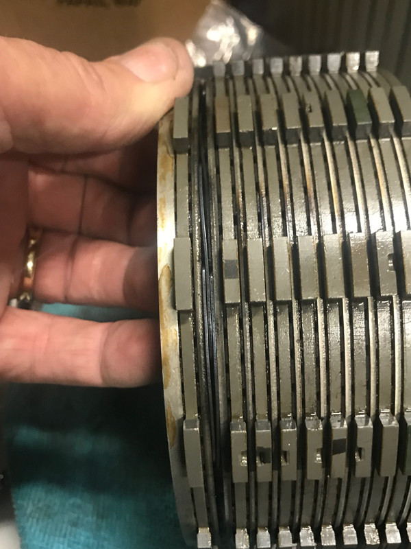

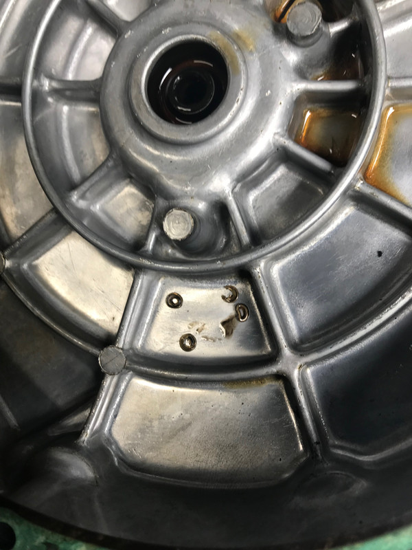

Hey Rob just went thru sheered rivets on a Tourer i just bought not my first by any means but if you need some help or tools let me know    Here is what you will find
This is what you want it to look like
« Reply #2 on: January 03, 2019, 05:10:35 PM »
Thanks, Dennis  cooldude I can use all the help I can get. I think the last clutch I rebuilt on a motorcycle was a Yamaha 350 back in '74. Matt, a kind member in New Hampshire was kind enough to send me a spare clutch basket and tools to use. (This club rocks !) Chances are I might hit you up for some advice though. Thanks  cooldude

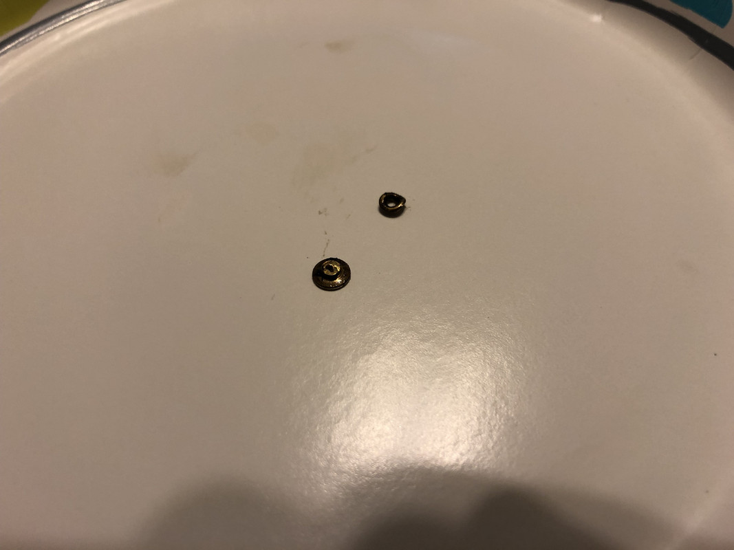

The culprit
matt
Posts: 577
Derry New Hampshire
« Reply #19 on: January 05, 2019, 03:04:35 PM »
That will do it. Dont forget on bottom right is pick up screen for oil pump clean that and make sure you reinstall it
« Reply #20 on: January 05, 2019, 03:19:01 PM »
Thanks Matt  cooldude yeah, I was looking at that black thing thinking what the hell is that ? Then I remembered reading about a screen. Pulled on it and it came out. Mine was really crudded over . I had to clean it up with some carb cleaner. Thanks again for the use of your tools. They will come in handy.  cooldude

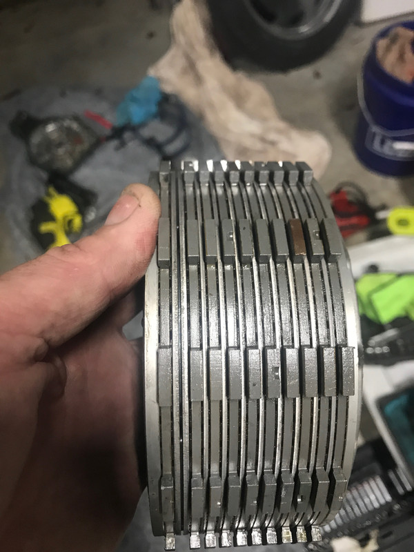

« Reply #21 on: January 08, 2019, 01:45:56 PM »
Finally got her buttoned up. Took me 3 days to do the job, I'm sure it could be done in 1 day by a competent mechanic. But, that's not me.  Undecided I want to thank all the members who have posted about this job previously, but I especially want to thank Matt for the use of his clutch basket and compression tools. They helped a ton. I put new fiber discs in because I figured after 140k they were probably wore. But they actually had little wear at all. One was slightly wore where a rivet probably got hung up. But I'm sure they were good for another 200k or more.
