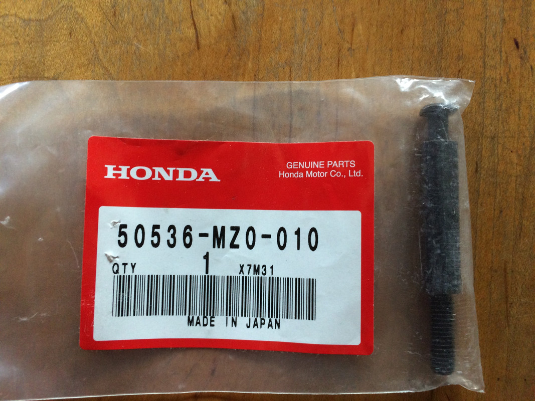

Posts: 14932
« Reply #2 on: October 27, 2021, 07:42:29 AM »
Lol. Ya it took me a while to figure that one out as well. I’m still using the bolt I made as a temp fix when mine broke around ten years ago.   Cheesy

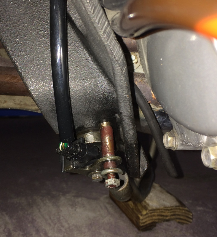

« Reply #14 on: October 27, 2021, 11:50:54 AM »
So, many, maybe even over ten years ago my spring stud broke.  I determined the reason these things break so much is that the barrel of the stud (the part that goes through the hole in the "keeper") is too skinny.
When I made mine I went to ACE Hardware and got a bolt with the correct thread and cut it to length  I also got a couple nuts and spacers.  I sandwiched the spacers between two nuts and snugged them up real tight and then ground the nuts smooth same diameter as the spacers.
Then I filed the spacers and nuts down until they were a snug fit in that keeper hole so it could not move back and forth.  The OE part can move some before hitting that keeper and I'm certain that is what eventually causes the breakage.
Now just to warn you...this is the dirtiest part of my bike and I didn't feel like cleaning it up any just for this picture.
« Last Edit: October 27, 2021, 11:53:11 AM by Chrisj CMA » Logged

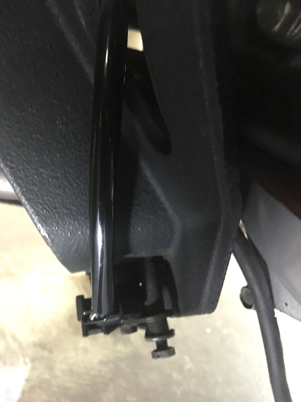

« Reply #20 on: October 27, 2021, 06:25:14 PM »
Lol...what a coincidence...just the other day when doing a detailed clean and inspect on the underside of mine, I determined that I should order a spare spring, bolt as I've noticed the spring getting a little tired. Hadn't got to looking up the part #'s yet, so THANK YOU for saving me this frustration...better  you than me  cooldude  Wink
Newsflash. I too thought the spring was getting tired but on inspection all looked good so I put it out of mind. Well after today’s picture I couldn’t help it. I had to clean that pivot point. Guess what, the spring came back to life. It doesn’t take that much crud build up to affect the function. Kick stand snaps up like it used to.
All cleaned up
« Last Edit: October 27, 2021, 06:29:03 PM by Chrisj CMA » Logged

Posts: 14932
« Reply #22 on: October 27, 2021, 07:17:15 PM »
I must need to do that.  My stand retracts, but it stops short of full return.
I'm not too hard on my bike, it's getting old too.
Clean and lube that pivot point and it will be like new again
