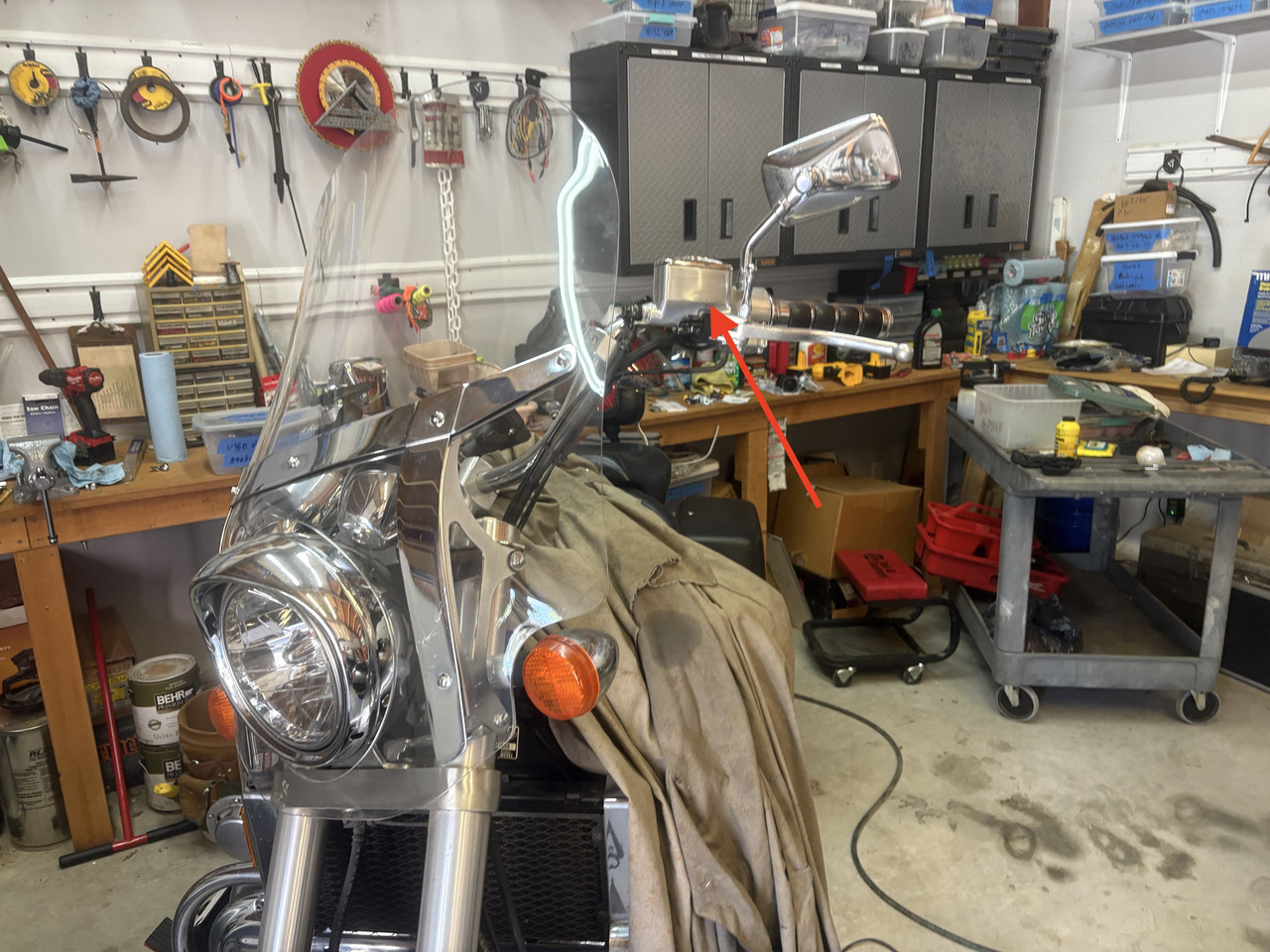

First some "history".  I have always had a mental issue with the location of the brake and clutch reservoirs.  When "my" bikes handlebars are positioned for a straight forward move by the bike, both of these reservoirs are angled.
In the first image below, the handlebars are turned far to the right and, as you can see (and probably know), the clutch reservoir (pictured in this image) is almost level.  Now if you turn the handlebars (again as you all probably know) the "straight forward" location, the reservoir is angled maybe at 30 degrees.
When I rebuilt the clutch reservoir and refilled it (as part of a repair to the reservoir because it leaked), I did it with the handlebars in the "straight forward" position.  In fact, when I rebuilt the clutch reservoir I was concerned about the amount of fluid in the reservoir and the angle the reservoir was usually at.  It seemed like it was not right. How would the fluid stay in there (well it had for years).
I was concerned when I tired to fill it with the handlebars pointed straight ahead, so, I raised the handlebars up a little to allow the reservoir to be at a smaller angel (but not much).

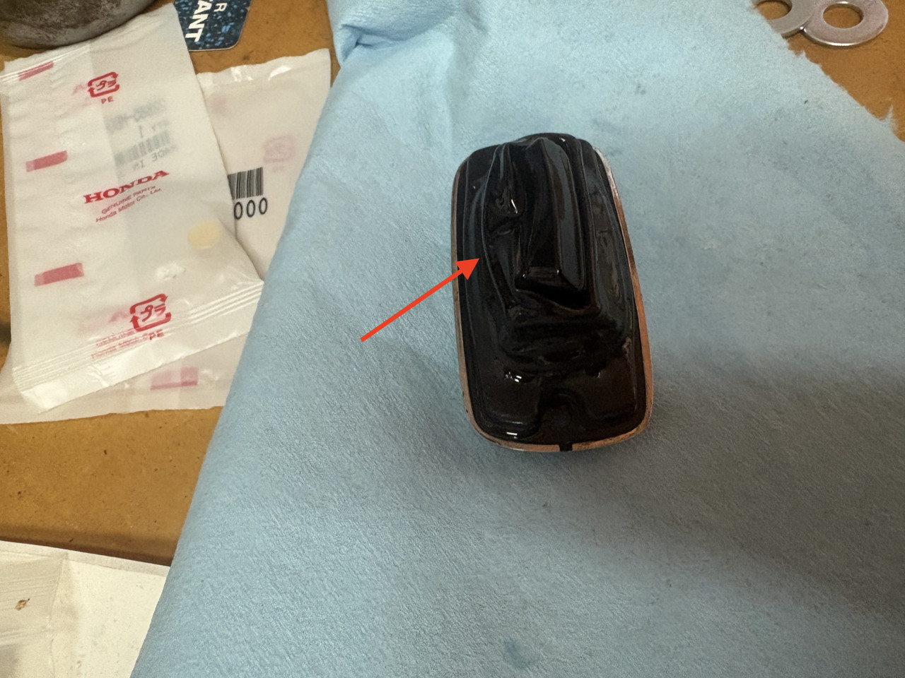

Oh, one more thing, the thing I think that is called a "diaphragm" is pictured below.  It looks a little "deformed" but it still inserted and sealed.

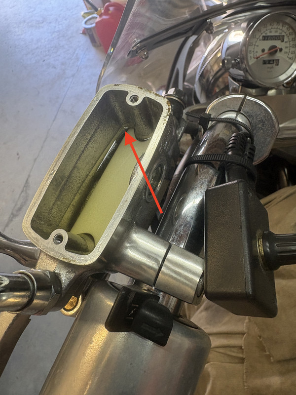

Ok here is a picture of the internal parts of the clutch reservoir as it was when I started the work today.
The arrow in the image was the level of the fluid in the reservoir.  As you can see, it was not high enough to keep the fluid flowing to the slave cylinder.

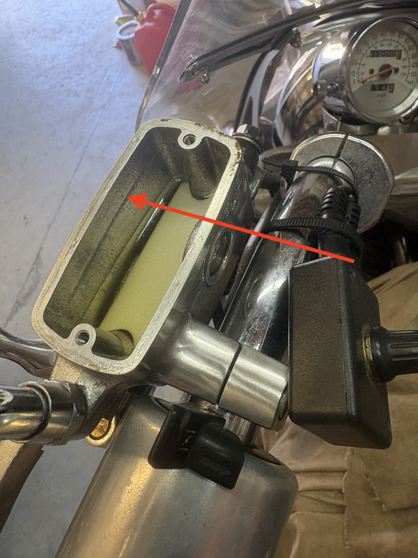

But back to the issue with the clutch reservoir and its tilt.  This time I turned the handled bars, as seen in the first image above, and filled the reservoir full.  The arrow in the image below shows the fluid level.
I then inserted the reservoir diaphragm.  I protected the area under the reservoir because I knew some fluid would be forced out but.....  I did not have an issue.
As I said, I was always sort of worried about the angel of the clutch and front brake reservoirs but never really did anything until this last clutch master cylinder rebuild.  I think that was an error.
I then used a hand vacuum pump and a reservoir connected to the clutch "bleed" valve and made sure the air was all removed.
When I handled the clutch lever, it was firm as it should be.
So, I believe I have resolved hte issue and it was not an equipment failure but a failure on my part to do what I had done in the past.
