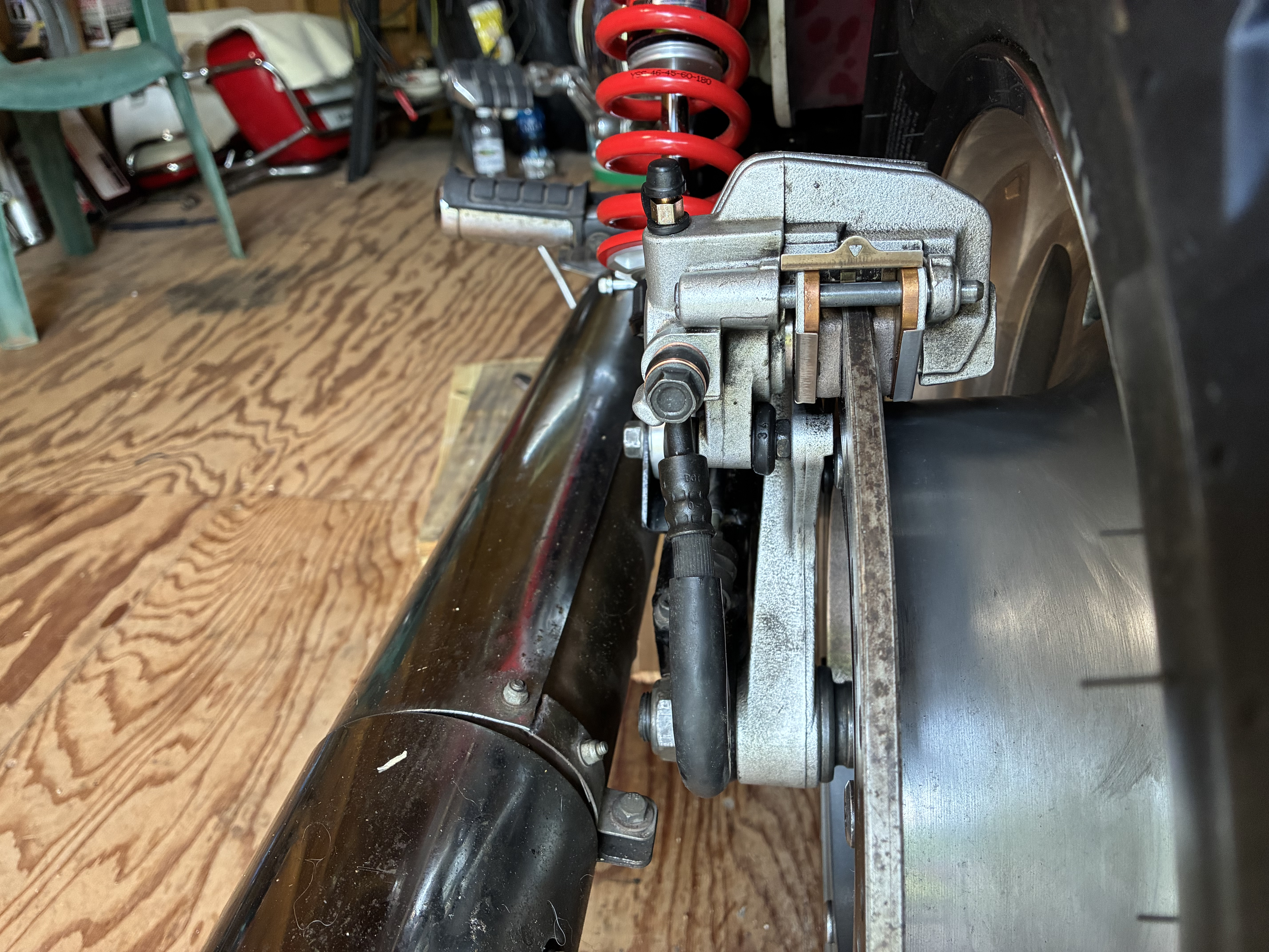

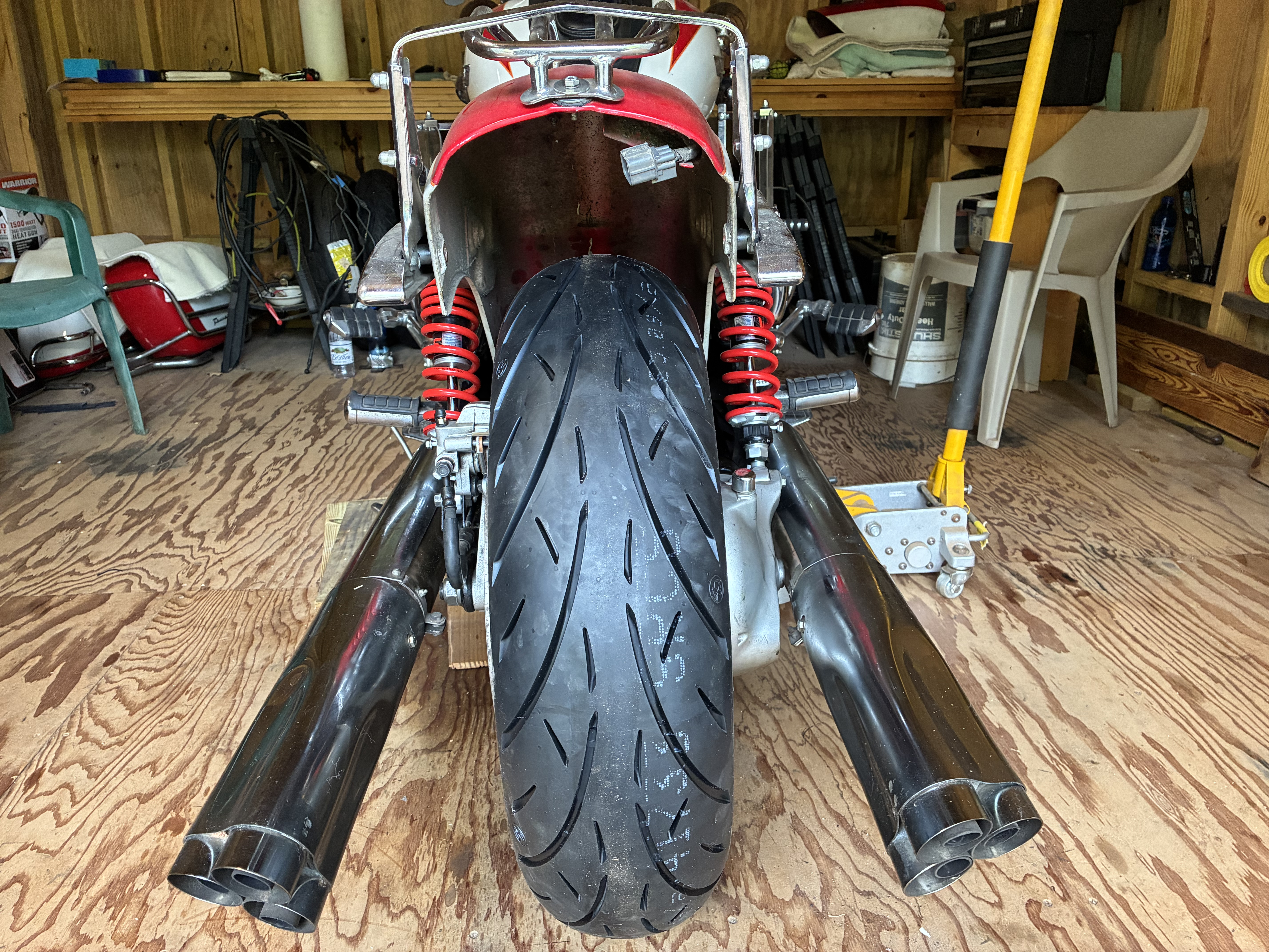

I started on the back. Hopefully no comedy. The new tire is on and the final is
pulled and still good... refurbish the brake caliper today and maybe back together...
I got new YSS shocks too. The Traxxion man told me that if I'd take the red ones he'd
knock off $100. I sent him a picture of my bike and he laughed  8)

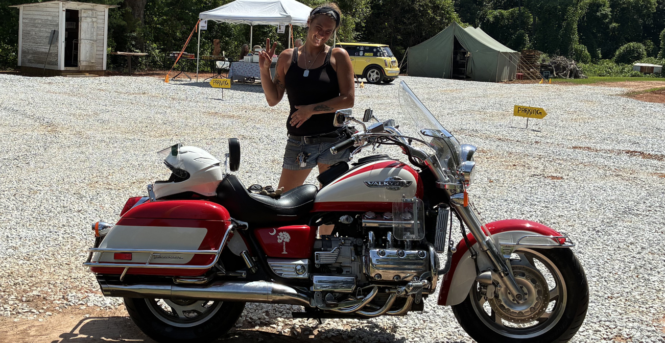

I took a couple of pictures before I put the tins back on...
I went up and down the street a few times, it feels great. The valkyrie has
introduced me to many friends and good times. It is terrific to have it in this
condition after 20 years :cooldude:  ...
Good brakes, good suspension (wow maybe), new tires. And it runs like a Valkyrie...
Definitely a lot cleaner (And better maintained) than mine, but after a day on the tender, my antique fired right up and took KK and I for a ride today. Still love these old bikes!
(And love the red shocks on yours!)

I took off on a 50 mile trip to the peach stand that's about 15 miles away...
The one finger front brakes felt just as I'd hoped. The new tires rolled great.
Even the freshly lubed throttle cable felt satisfying, it has been some number
of years since I did that.
I wish I could say intelligent and objective things about the suspension... it
is not floaty 1970 Cadillac suspension, it is "feel the road" suspension. My old
440 shocks were just hard and tired. These fresh shocks have more travel. I think
suspension is for keeping your wheels on the ground and taking the hits without jarring
your teeth... like when I hit several construction hard edges coming out of
Westminster  :cooldude: plus all the other South Carolina pot holes I encountered
along the way.
Sam, who owns my favorite peach stand, appreciates good motorcycles. She came
over to ask about it, I think the reflection of the chrome was making her squint...
