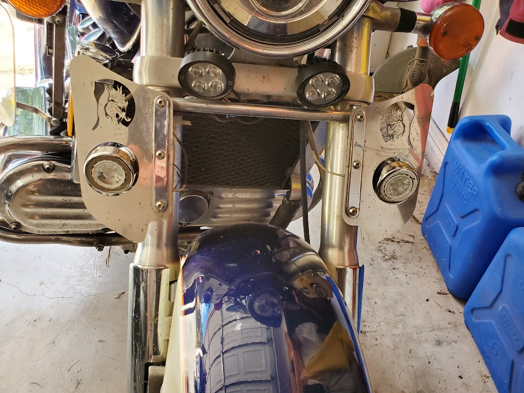

I mounted some LED lights on the cross member between the front forks... I can look closer to see exactly where I mounted 'em but might be an option for somewhere to dangle some attention getters?
Jersey mike
That's a nice set up Serk, I like those wings with the dragons. The lights must illuminate the road nicely in front of the tire and certainly alert other drivers down the road.
That could be a good set up for a set of horns, up front and wide open with nothing to obstruct the sound.

I definitely didn't drill anything to do that. After work I'll go get a closer look at exactly how I did this and try to share some pics.
Okay, so evidently there are 2 bolts than hold the headlight bucket to the cross member, I evidently took 'em off one by one and slipped a bracket in there for the lights...
Sure you could get an L bracket and work something up similar to get some horns in there with a little creativity (And no drilling on the bike)

Quote from: Serk on Thu 25, Jun 2026, 16:30:32Okay, so evidently there are 2 bolts than hold the headlight bucket to the cross member, I evidently took 'em off one by one and slipped a bracket in there for the lights...
Originally was going to mount the horns exactly the same way you mounted your driving lights.   But due to the ridges on the underside of the stock bracket there isn't significant space to mount much of an "L" bracket and I am afraid between the shocks of riding bumpy roads and the horns weight is likely to be heavier than your driving lights which I believe would exacerbate the stress on the bracket I installed.  Additionally the bolts being discussed don't have a lot of length to secure a bracket securely.

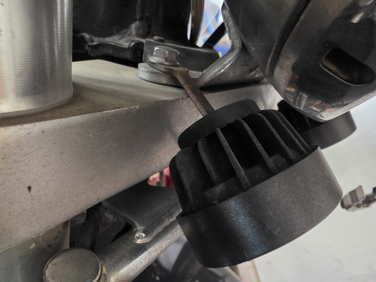

I've had a mini air horn mounted here for years. Very loud and lasts a long time out of the weather and road debris. This is a Stebil but Wolo makes the same unit.
