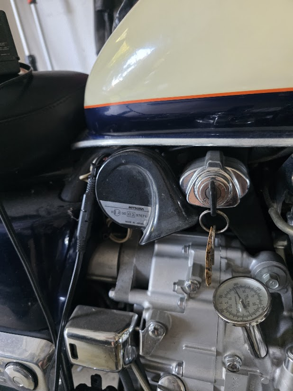

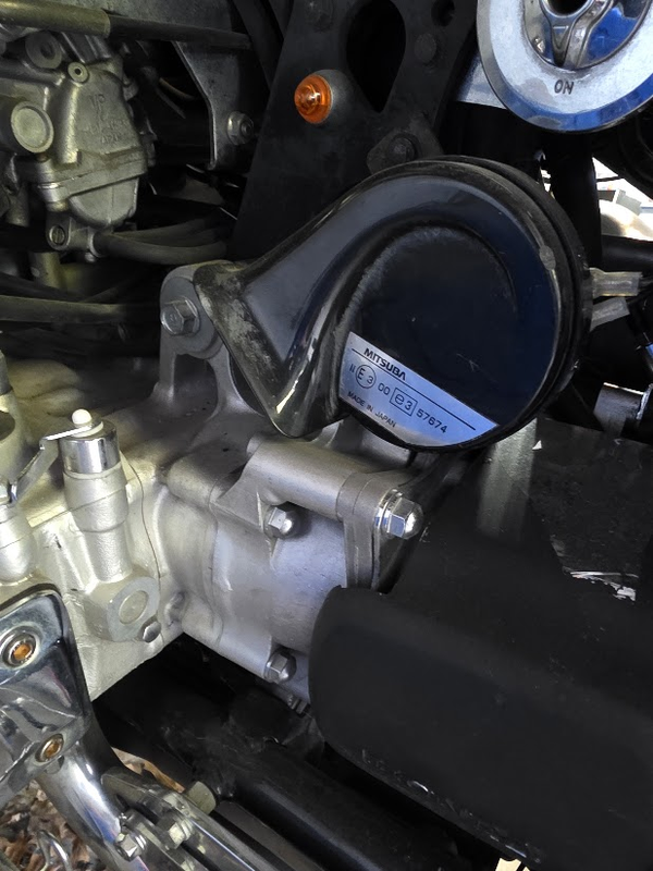

Not the prettiest things but they were inexpensive, reliable and LOUD. I got a set of horns off a GL1800 Gold Wing and mounted 'em on either side of my Valk...
Just took some pics to give you ideas of what might work for you... or not...
