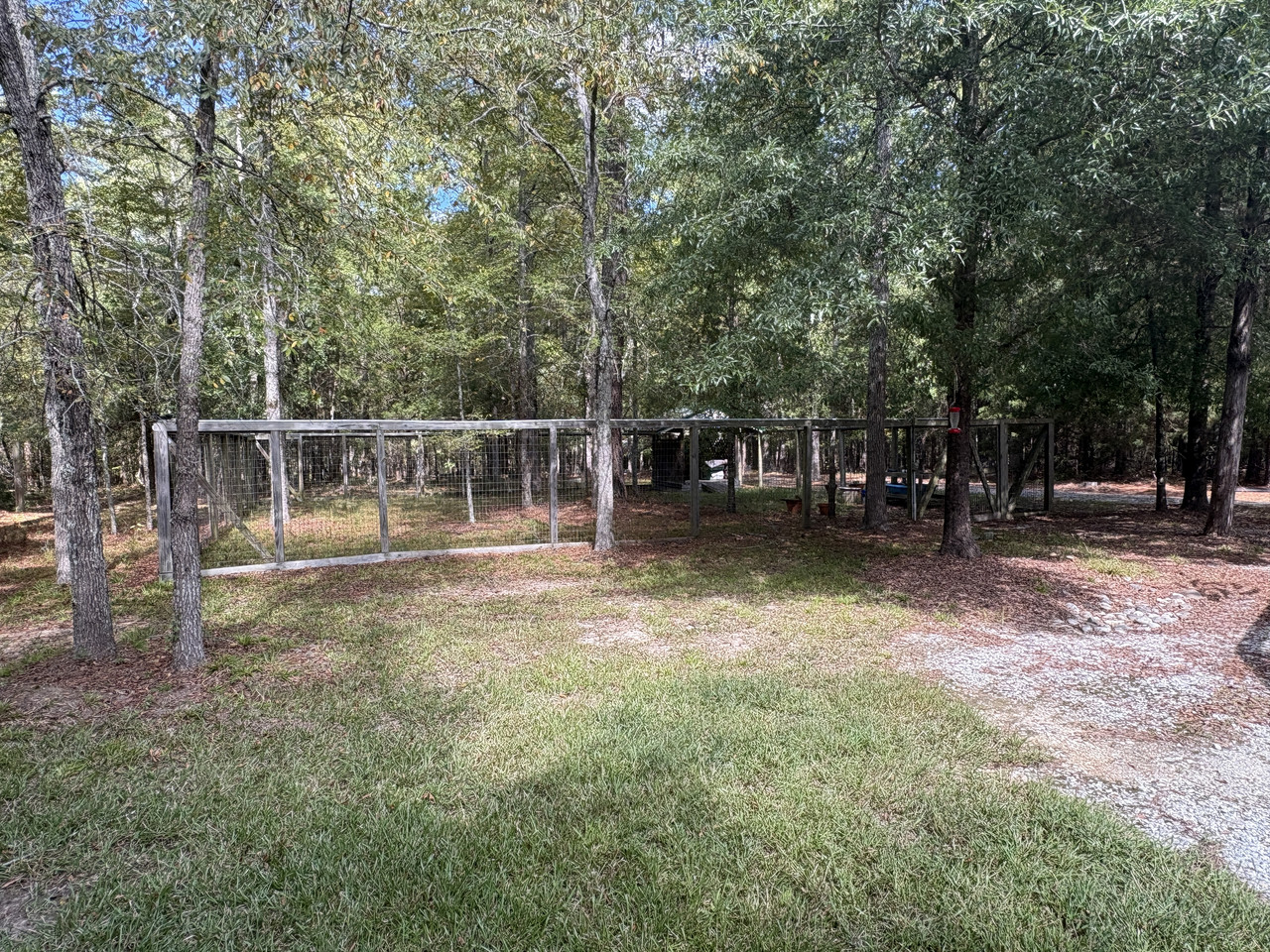

While I do not have a lot of experience in building fences and gates, I have done some work at our home that resulted in a "Large Dog Run" and some other things that I hoped would be there for a few years (well maybe 10 or 20).
As mentioned above, properly treated wood will last well.  But it has to be properly treated.  While I cannot personally document what I am about to say, I can show you examples.
One thing I first noted when I started building our new home was a series of "fence posts" around one part of the adjacent property.  It appears that these posts were part of a fence that was built many years ago.  In the main, while the fenced had been "injured" by falling trees, the fencing material (like that use for farm ares) was intact but a little rusty.  What struck me most was the fact that the "cedar" posts were still mostly intact.
Now, when I built my Dog Run, I did not use cedar posts but I really thought about it.  Instead I used "Pressure Treated" 4"x4".  These posts have a long life span (well for me so far, ten years plus) and are strong.
Of course, if you are going to build this around your home, you do have to consider how the material would impact your view.
But, if I were going to build a fence surrounding my property, I'd probably elect to use Pressure treated 4"x4" whose length would depend on the fence hight.
Now as for the gate, I would use some metal posts for the gate poles,  I have some metal lamp posts that have withstood the weather for the last 10 years or so.  But you have to ensure that the metal posts are apporopite for your job and properly treated.
I would anchor these posts in "concrete".
As for the fence material, the only material I have ever used for fencing (again for my Dog Run) is metal fencing.
Also, I did anchor the top of the metal fencing to prevent the metal from moving (I guess swaying).
Here is a picture of my Dog Run.
Regarding the "Pressure Treated" wood.  Ensure that it has been properly "Pressure Treated".  I have not really looked at the standard in recent years so, I cannot provide that information but I do believe there is more than one way wood can be pressure treated and, of these, one is better than the rest.  It will cost more but it will last longer.
And yes, I have some wood that I thought was pressure treated but did not stay free of degradation.  It may have been misplaced or improperly "stored" at the place I purchased it.  Or it may have just been a cheap method use.  All are not the same.
Enjoy your project.

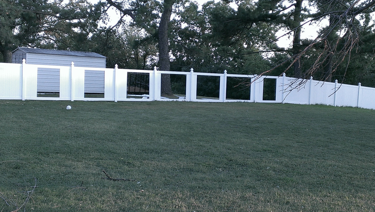

A couple things to think about on vinyl fencing.  My neighbor has a vinyl fence between our yards and it looks very nice.  It's low maintenance with about the only thing it needs occasionally is being washed off due to mildew or mold growing on it.  However as you can see from the attached picture they are not the strongest. This picture was taken after we had high straight winds and the vinyl flexed enough to come out of their upper & lower beams.  We had already fixed most of it as almost every section was missing panels. His fence was the only one in the area that had any issues but we did lose quite a few shingles.  Also since it's vinyl when it's cold the vinyl gets brittle and can crack or break if something hit's it.  I know he has a couple holes in his fence that he'd like to fix but in his case the particular panels are no longer made or available so he's out of luck.

Quote from: Timbo1 on Fri 02, Oct 2026, 16:20:05A couple things to think about on vinyl fencing.  My neighbor has a vinyl fence between our yards and it looks very nice.  It's low maintenance with about the only thing it needs occasionally is being washed off due to mildew or mold growing on it.  However as you can see from the attached picture they are not the strongest. This picture was taken after we had high straight winds and the vinyl flexed enough to come out of their upper & lower beams.  We had already fixed most of it as almost every section was missing panels. His fence was the only one in the area that had any issues but we did lose quite a few shingles.  Also since it's vinyl when it's cold the vinyl gets brittle and can crack or break if something hit's it.  I know he has a couple holes in his fence that he'd like to fix but in his case the particular panels are no longer made or available so he's out of luck.
Wow that's a shame.
I didn't think about anything going out of production but I know the vinyl doesn't like to cold and can crack and break on impact.
Maybe vinyl is out of the equation for us. On the one side of the house it's high volume usage.
