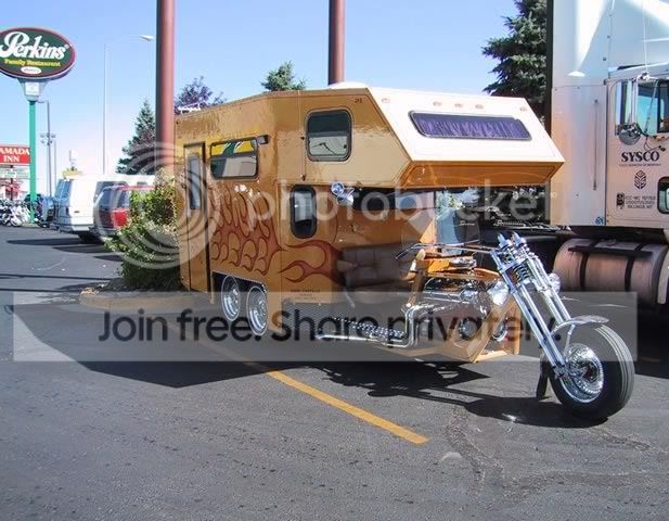

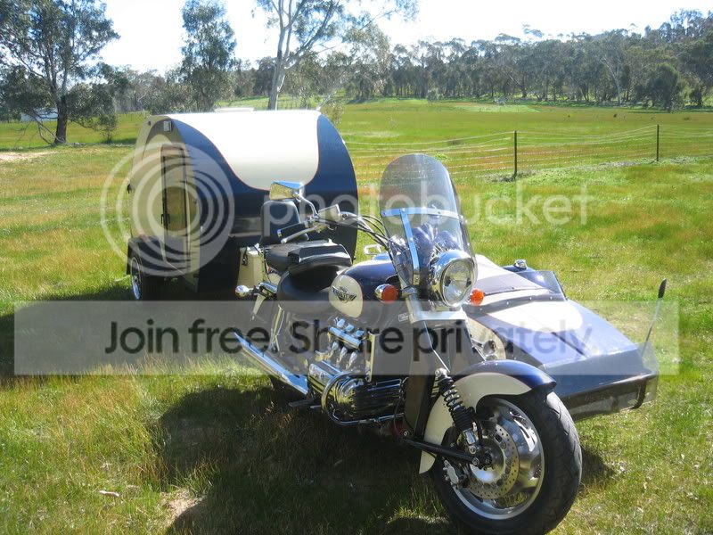

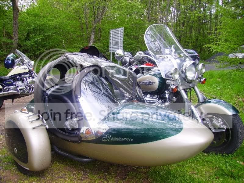

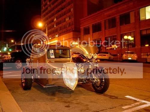

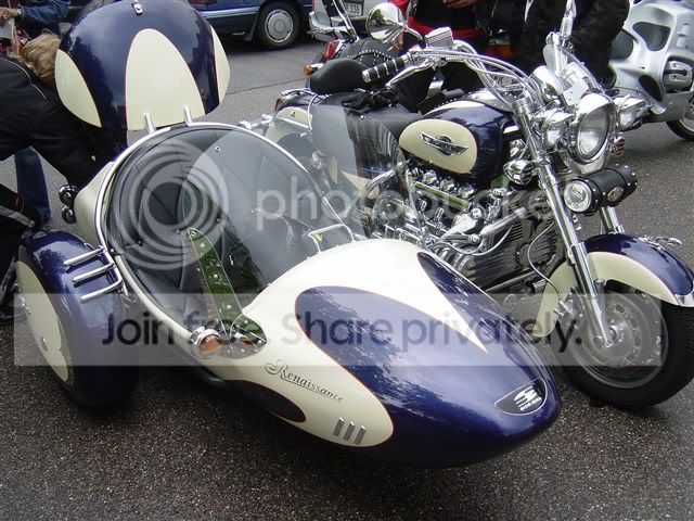

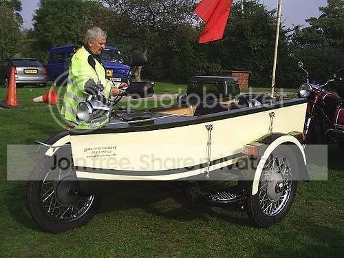

...heres a few picz Ive collected in my travels on the net..
. ...now this is the baby Id like to have....best of both worlds ! ..  coolsmiley
« Reply #26 on: November 15, 2012, 09:33:23 AM »
Dave, last  I heard that rig you's like to have is for sale in California, he is asking $48,000 last I knew.  I think that is the price.   Don't know if it is sold or not.
