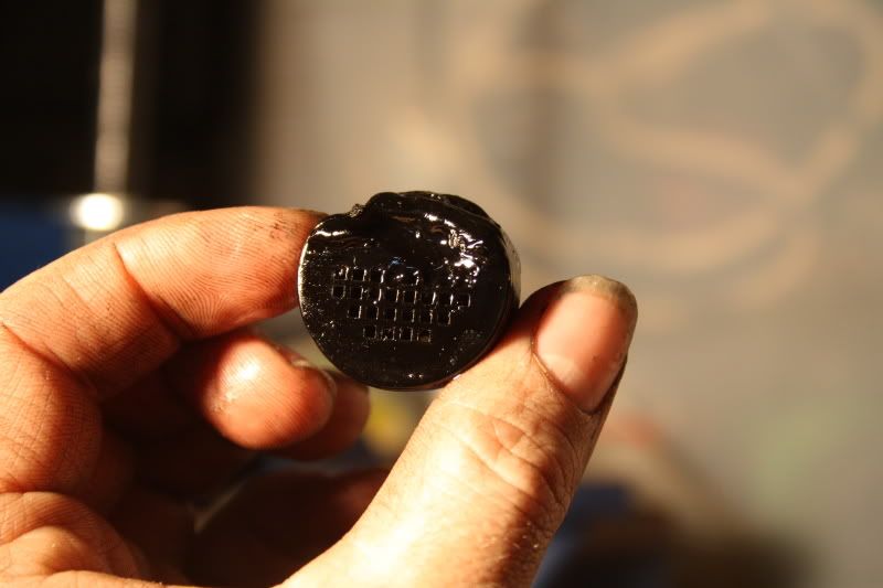

The first thing I found was at some point it was mighty darn hot in the rear case.
That's a melted scavenger filter.  It may have occured when the first clutch was replaced.

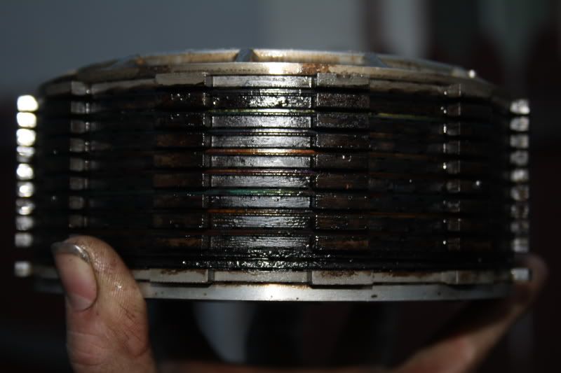

There is bluing of some of the pressure plates and evidence of heat/oil abuse.
I pulled off the spring using a similar setup to Pruor's and several friction plates are shaved down and toasted.  No pics of those today.
