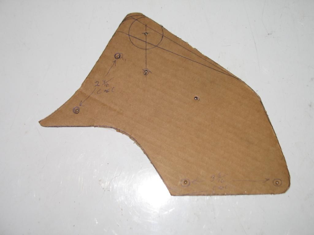

« Reply #19 on: March 07, 2015, 06:24:05 PM »
OK RJ,  Here are some pictures.
My rememberer was not workin exacly correct it seems.  I had only raised the pegs 1 1/2 inch and I mounted the boards about 1/2 higher than stock pegs.

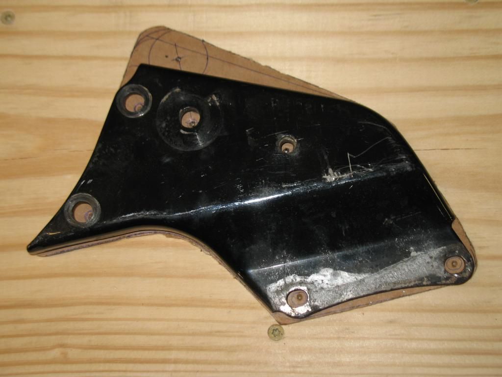

The original peg and muffler brk:

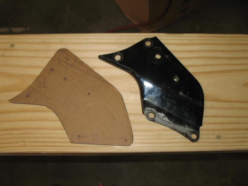

Original brk laying on cardboard template:
Cardboard template showing some hole locations:
I cut the brakets out of 3/16 steel and reinforced the back side with a 3/16 x 1 x 2 1/2 over the peg holes.  I also welded a 5/16 rod close to the edges to stiffen the bracket.  I left the plate flat where the mufflers bolt even though the OEM is offset inward just a bit.

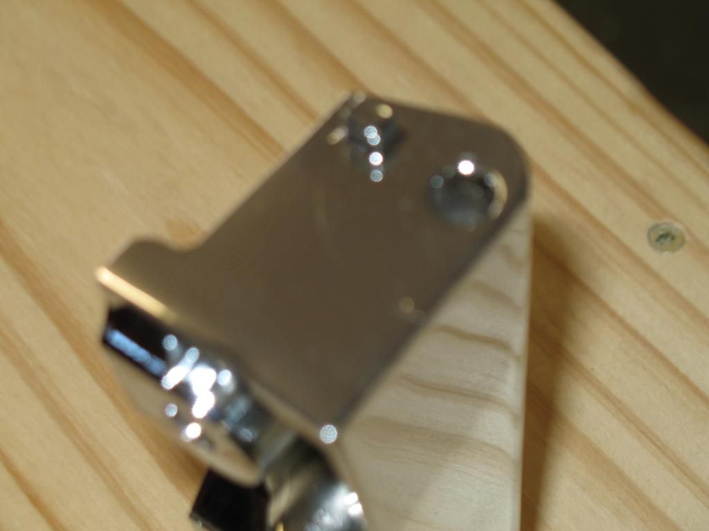

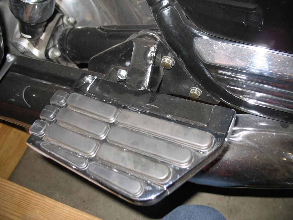

I threw these pieces of the Kurys on the shelf and replaced them with a piece that I made to bolt thru both of the peg holes in my hangar brk.  This way, the floor board will not tilt even if someone jumps on the front edge of them.

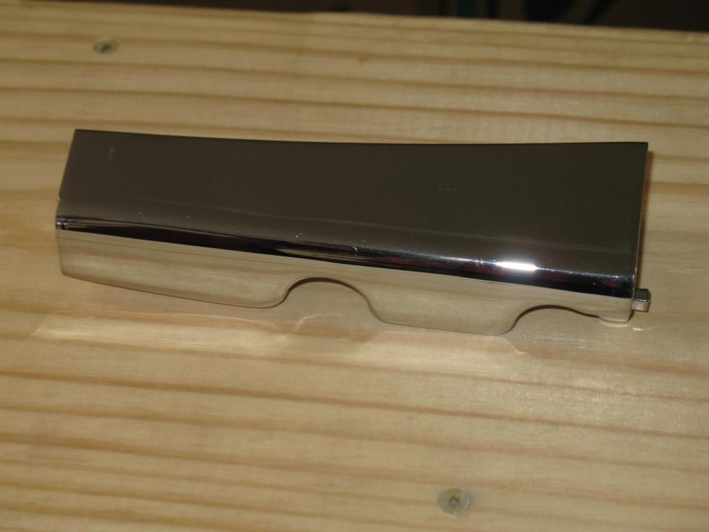

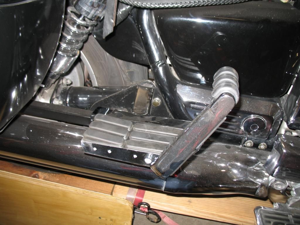

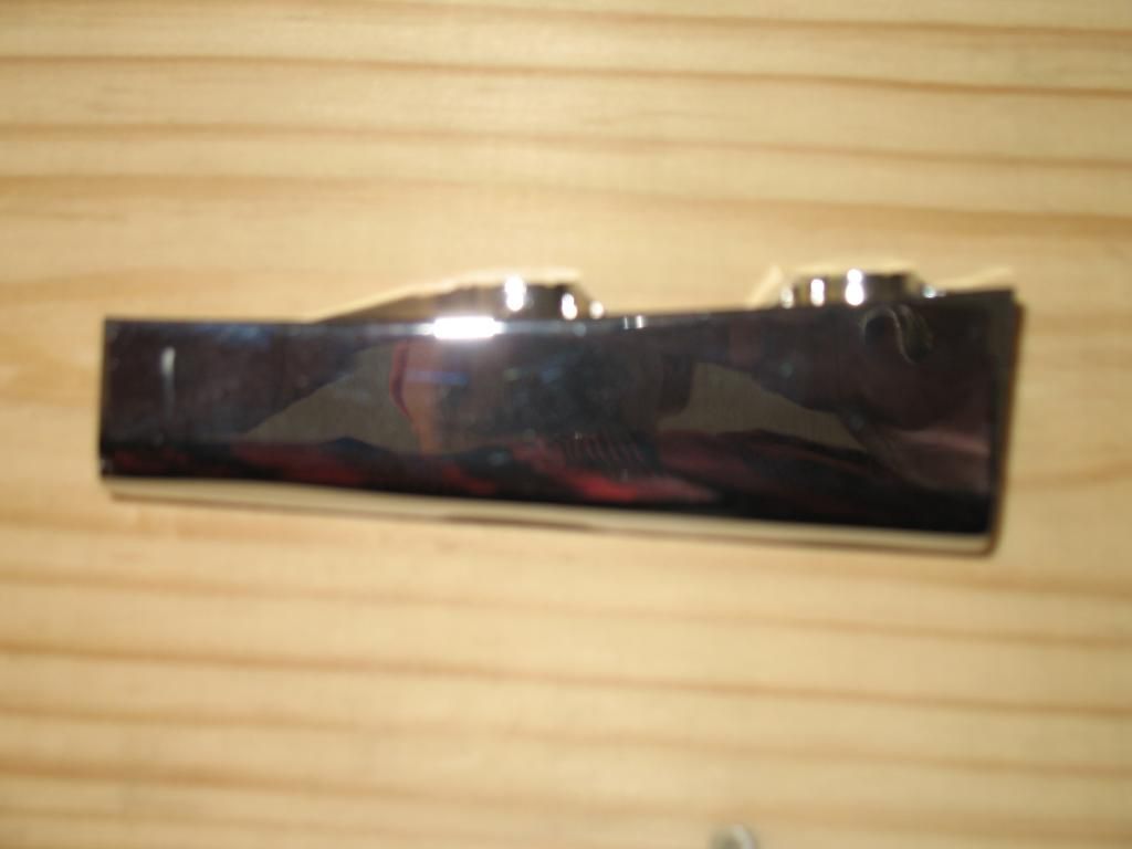

I included these here to show how the ends are formed.  One hole goes thru the whole unit.  One end has a second hole which is for the detent spring and ball.  The other end has a raised stop block.  I just drilled another hole and pressed a pin in it on the mounts I made to replace these pieces.

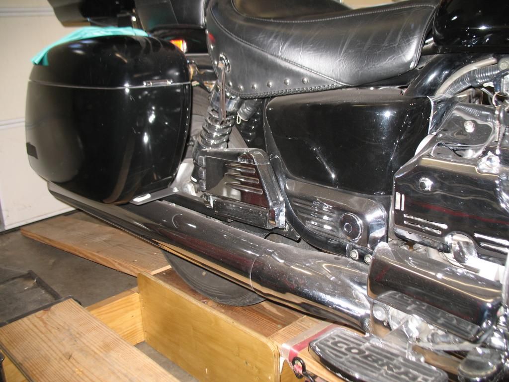

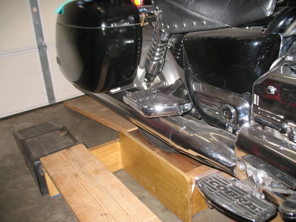

This is how it looks on the bike.  Please excuse the dirt and dust.
The brackets/mounts I made are 1 1/4 square tubing with .090 wall.  I welded solid square pieces to each end to drill the holes for the hinge pin, detent spring and stop pin.  Then I welded a piece of angle iron to the side of that square tube and drilled and tapped it for the bolts thru the muffler/peg hanger brk.  I welded another piece of steel strap on the top of the brk so as to cover the mounting bolts and make that area look cleaner.

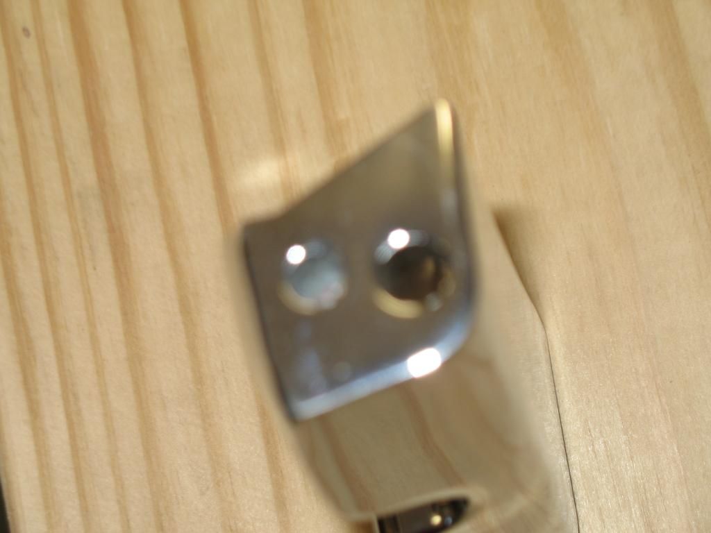

If anyone decides to use these Kury Transformer boards, I would suggest they order the boards for something other than the Goldwing.  The top of the Goldwing floorboard brk is curved and just does not look right to me.  If it were straight (I think the others are) then it would be really easy and clean to just cut a steel bar to bolt them to and weld or bolt that to the muffler brackets.  Maybe you can see the curve and how the bolt bosses stick out in these pics:
