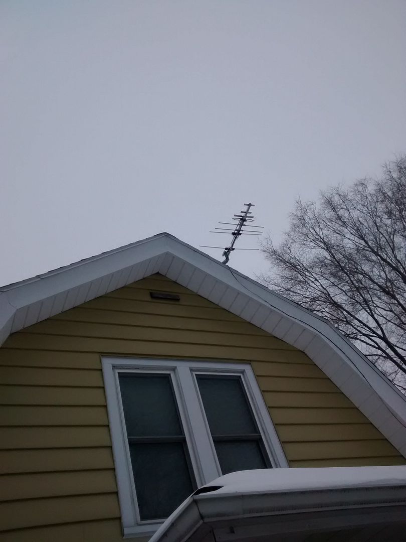

« Reply #7 on: December 31, 2015, 09:28:58 AM »
For an antenna to work well it really needs to be outside and away from any solid obstructions.  We went with a low cost directional antenna pointed at towers 35 miles away, coupled with an amplifier and are very satisfied.
This Christmas we picked up a Roku TV, which in addition to antenna TV is connected to our home's WiFi and allows streaming of Netflix, YouTube etc.  There is also relatively new Sling, which I have not yet tried, which has a similar channel line up to cable.
