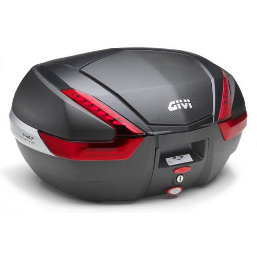

Unless you need locking storage badly, you don't really need a trunk.  Use helmet locks, or take them with you.  Use a good waterproof duffel for stuff (and a good size one will take two full face helmets).  Otherwise, a good Givi, of the size you need, mounted to the luggage rack (or maybe a bigger flat plate on the luggage rack) will do the job, and not look terrible.  And some have lights.
Then you don't have to worry about the OE mounts, interstate fender struts, wiring harness, and paint.

« Reply #19 on: July 30, 2018, 07:38:10 PM »
How big is the large Givi trunk?  Can it fit two full face helmets?
It looks like this trunk sits high enough and far back enough to allow the saddle bags to open without having to modify the ones I have?
