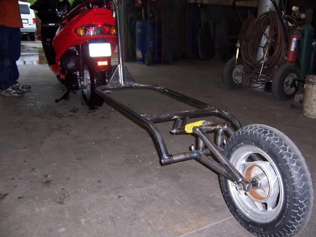

« Reply #3 on: October 31, 2018, 12:11:25 AM »
One of my riding buddies is putting plans together to make one, has the scooter rim, a plastic box to fit on it, we looked at a bike swing arm but dropped that idea and will build the swing arm to suit the size we want
I will be helping build it...I am going down the 2 wheel trailer build track as I don't want the extra weight on the stand for softer ground (mid winter camping)
 this trailer was on one of our evening rides, it seamed to tow well Smiley

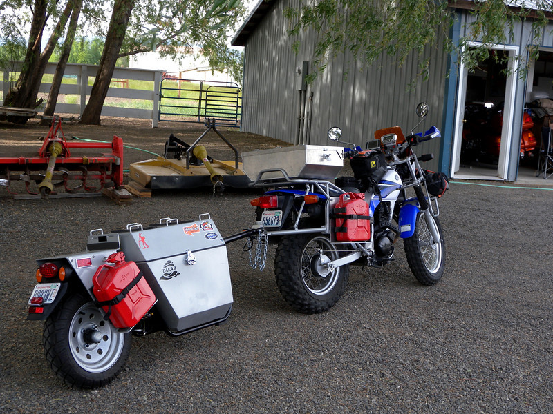

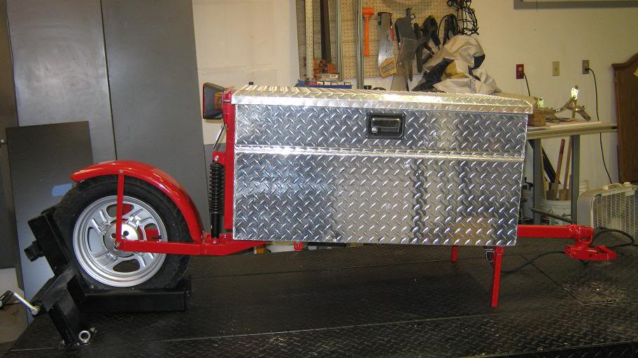

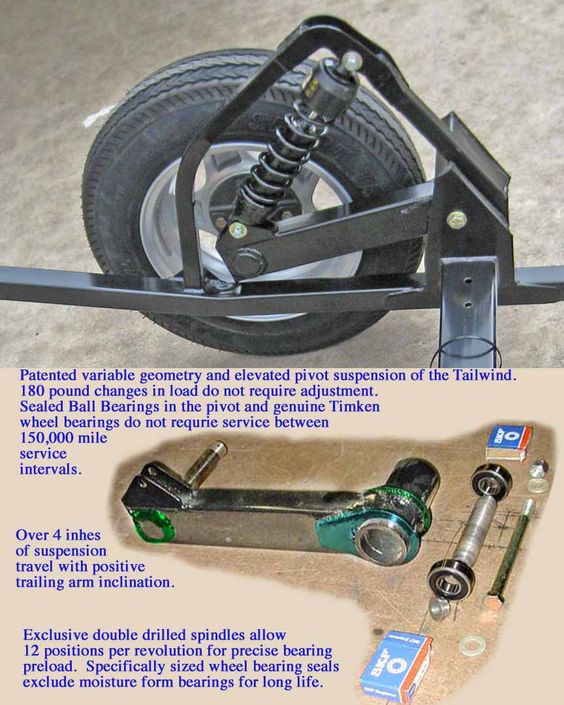

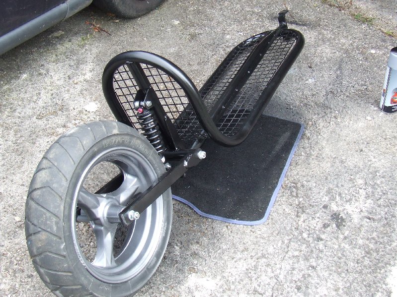

« Reply #8 on: October 31, 2018, 07:25:41 PM »
Single sided swing arm has merritt if you need to fix a flat tire... but here is just a couple of pics I have on file for ideas.... I was going to go single sided swing arm but I also like the suspension on the one behind the red scooter....with a few mods
