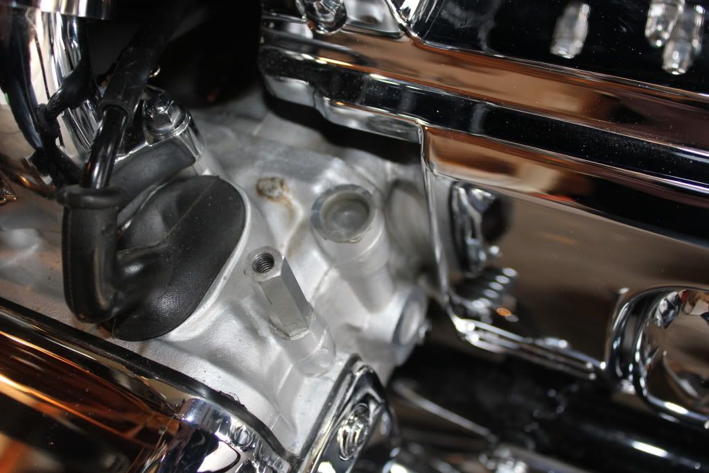

After replacing the exhaust gaskets did not get rid of the ticking sound, closer inspection revealed something much more disheartening.  :'( Embarrassed Angry
I found the source of the tick here:
What do you recommend as the best way to fix this?

That does not look like a freeze plug you pounded in there.  I would use the quick set JB Weld to fix those cracks in the casting.

doesn't look like the 9/16" freeze plug that we normally use.  I usually tap the plug in and it goes in much farther than yours did.  Then I buy a tube of the two part epoxy that comes in a plastic tube and is gray on the outside and has a strip of black inside.  You cut off a section that fits your application, then knead it until it is uniform in color, then fill the void.  J.B weld may work, or a two part liquid epoxy.  Not that much pressure there, just opens to the exhaust.  You could possibly drill and tap it and pull out the old plug and start over on that one cylinder.  Clean it up good if you do remove it, then put in the 9/16" cup plug and fill the top with J.B or epoxy.

Dave, I've done 5 Valk desmogs & never had that problem. Like Terry said it appears that too large of a block off plug was jammed in there. That plug looks solid. The reason we use cup style freeze plugs is they "give" & kind of self center when tapped down.
The good news is if you can get what's in there back out it looks like a fixable problem. Down in that port it actually necks down to a slightly smaller diameter. Even if that round part of the casting breaks, as long as there is still is enough hole left to stick a proper size cup plug in it can be fixed. The epoxy that Terry talks about can be used to put it back together. I have used JB Weld like "bondo" before. After it cures you can shape & sand it to completely repair the broken casting. I have a real good match silver engine paint to hide the "body work".
JBWeld does not like direct exhaust blowing on it but will stand up very well behind a metal plug. Even if the 9/16 freeze plug will not block the port there may be enough meat in the head to tap it for a pipe plug then do the "body work".
Don't sweat it, we'll figure it out. Wink

I'd pull that plug out, if it comes out easy, and put in a freeze plug. The cast may spring back and when the plug goes down further it my not leak.

I appreciate your responses, but am a little ticked off for this reason...
...that "plug" came in a $60 desmog kit from one of our beloved vendors.  Not knowing any better, I just pounded the thing in there.  Fortunately, the other three did not crack, just this one.
Eddie - I shoulda done your nickel trick to begin with and been done with it.
Terry - I'll check into that stuff you mentioned.
You guys up for a wrench party (or more accurately a JB Weld party)?  cooldude

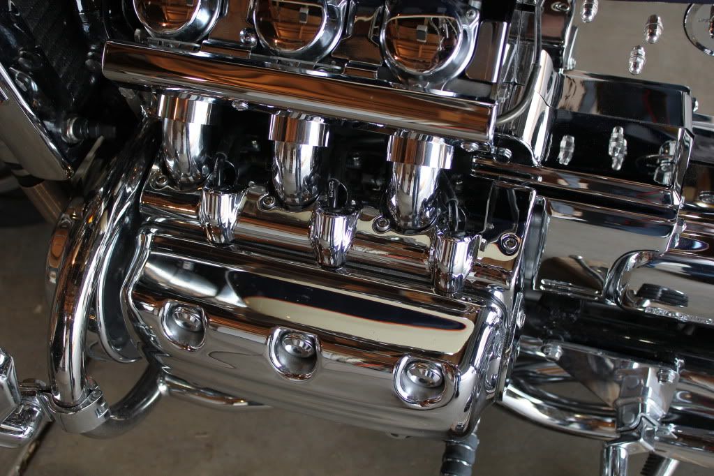

If you don't like the way JB Weld looks (I don't mind, it's hardly noticable right there) then you can always cover them up.

Pretty sure you've got the same 'kit' I do, and I think ya goofed...
The instructions say to tap the plug 'Flush' with the block.  Looking at the picture, it looks as though you have it tapped in so far, that it is resessed about 1/8".  The plugs are tapered to exact specs, and pushing them in that far will give you the result you got.
I know that is not what you wanted to hear, but your situation can be fixed, by cleaning up the areareal well, and gooping some JB Weld in the crack, and over the plug.  May not be as pretty, but you will be back on the road, once it dries.

Dave, underneath those nickels are both a 9/16 cup plug AND JBWeld. The nickel is JB'ed on just for looks!  Wink
I agree you must have gotten the plug cocked a bit.

i could be wrong. it's happened before..but looks to me like he put the freeze plugs in upside down..beating those in upside down will mushroom the plug and create the result you see.

I take full responsibility for the damage done.  It's not the vendors fault.  I was just expressing frustration at the thought that POSSIBLY the kit contained the wrong parts since the first several responses indicated that it's not the freeze plug commonly used.  I spent $60 for the kit for the convenience of having everything I needed delivered to my door instead of piecing together my own kit for much less $$$.  My time is incredibly valuable to me, and I made the decision to spend more money to save some time.  Anyways - I have made other purchases from the same vendor and am very pleased with the customer service and overall experience.  No vendor bashing intended - just venting on my part.
I'm sure I put the plug in upside-down, or pounded it in too far, or ____ (fill in the blank with one of the other 200 things I did wrong that night while working on my bike).  I'm still a newbie in the Valk world, and fairly unexperienced at wrenching.  But I figured there was no better way to learn both than roll up my sleeves and jump in.  I was right.  I know a lot more about the Fat Lady now then I did before.
Seems like the consensus is to JB Weld the sucker.
What is the proper name for those chrome covers in Chillerman's post?  I want to call them "Rivco Spark Plug Valance", but I don't know if that is correct or not.  Aren't they discontinued?  If not, where do you get them?  Also seems like I read somewhere on here that they have to be modified to fit an I/S with pods.  Any insight?
Got the right name, just the wrong vendor...  They are made by Kuryakyn  cooldude

Thanks for that link, Black Dog!  They are cheaper than I thought.
Do you know if they have to be "tweaked" to fit an I/S with pods, or are they just bolt on?

« Reply #15 on: January 31, 2011, 09:16:37 AM »
At one time, they made those for the I/S.  That being said, the ones for the Standard/Tour do need to be modified.  I know other guys have done it...  Maybe they will chime in.
Actually they DO NOT need modified to fit the I/S. I have a Standard/Tourer set on mine went on just fine. The only difference you will see is it takes just a bit more effort to put your pods back on after removing them.

Excellent.  Just ordered a set from the link.
Time to pick up some JB Weld, wait for the new bling to arrive, and get her back better than before.

They can be a pain to install even on a standard.  I found if you pull off all of the spark plug boots and run the cables through the valance first it makes it easier.  Then you can rotate the valance down and carefully make sure the boots are fully on the plugs before bolting it down.  If you start a thread about your bike not running right after install, we will know what it is!   Grin

I asked if the Kury covers fit an I/S with pods.  The answer that they do not need to be modified to fit an I/S with pods is correct.
What I SHOULD have asked is "do they fit an I/S with fog lights?"  This completely different question gives a completely different answer.
Unless I'm missing something, the covers have to be modified to fit an I/S with fog lights.  There is not enough clearance between the bottom fog light mounting bracket for the cover to fit without modification.
Anyways, a little redneck engineering got 'em on.  It nicely covers up my JB Weld job (which looked pretty dang good if I do say so myself).  And most importantly, no more annoying tick-tick-tick!

Just trying to do away with potential vacuum leaks was my biggest reason.
The pile of parts removed from a de-smog.
Top of engine after removal.
Much simpler vacuum hose mess now. No performance increase just peace of mind for me.
