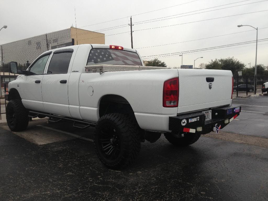

« Reply #31 on: February 08, 2014, 02:11:38 PM »
124k on my '06 Megacab 4x4.  Still going strong.  In this pic it is covered in ice!
